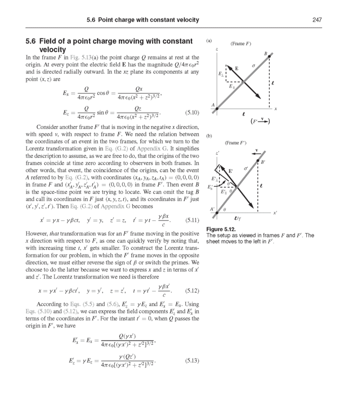

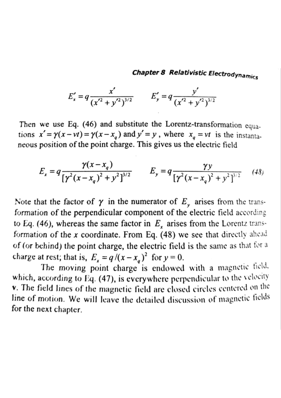

I am browsing through E&M by Purcell and Morin Chapter 5.6 and have some confusion.
Since it is stated that ##E'_x = E_x##, I am going to set a special case where ##z' = z = 0##, ##E_x## in (5.10) reduces to,
##E_x = \frac{1}{4 \pi \epsilon_0}\frac{Q}{x^2}##
However, ##E'_x## in (5.13) reduces to,
##E'_x = \frac{1}{4 \pi \epsilon_0}\frac{Q}{\gamma^2 x'^2}##
There is an extra ##\gamma^2## factor in the denominator, why is that so?

x' is not equal to x. Recall that (t,x) and (t', x') are related by the Lorentz transform.
Yeah, so I have to apply the Lorentz contraction ##x' = x/\gamma## in order to get the same result.

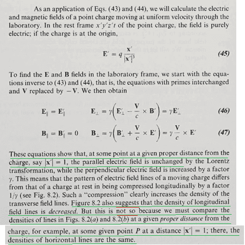

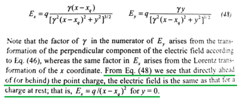

Also, I have a similar confusion when reading the same topic from a different book, from Ohanian.
You can see in the last sentence of the second paragraph, he stated that ##E_x## must be,
##E_x = q\frac{1}{(x-x_q)^2}##
which I think is missing a ##\gamma^2## factor in the denominator as can be deduced from (48). Is that a typo or I missed something? I have consulted the Errata sheets for this book and that is not listed as one.

No. You have to use the Lorentz transformation to convert ##t## and ##x## to ##t'## and ##x'## and vice versa. You can't just look at ##x'## and ##x## in isolation, because of relativity of simultaneity. The book you quote in the OP gives the transformations as equations 5.11 and 5.12. You have to use them; note that neither of those transformations contains ##x' = x / \gamma##.
In the sentence above (5.13), it is stated that the case considered is ##t'=0##, meaning the case considered is that both frames coincide.
I don’t see what your confusion is. You’re right, they’re only evaluating ##E_x## at ##t’ =0##. So plug that into your equation ##E’_x = \frac{1}{4 \pi \epsilon_0} \frac{Q}{\gamma^2 x’^2}## and what do you get?
"Both frames coincide" is not a correct description of what ##t' = 0## means. It means you are only considering events in the hyperplane ##t' = 0##. Events in this hyperplane do not all have the same value of ##t##. The particular event where the charge ##Q## passes the origin of the primed frame has ##t = 0## and ##t' = 0##, and also has ##x = 0## and ##x' = 0##. But this is the only event where things "coincide" in this manner.
I understand what you're saying, I think a better term is "origins coincide". All that in correspondence to what the book is implying where it set a special case of ##t' = 0##.How about my second question in post #3?
Purcell seems to systematically confuse the issue of relativistic electrodynamics and with that the students.
The most simple way to get the fields for the uniformly moving point charge is to start from the Lorenz-gauge vector potential in the rest-frame of the particle (inertial frame ##\Sigma'##), where

It looks like you’re comparing eq. 48 to the equation at the end of the paragraph. At y=0 and for a charge at rest, eq. 48 reduces to the equation at the end of the paragraph. You’re welcome to add gamma’s in, but when it’s said “at rest”, the implication is that gamma equals one.
Again, I’m not sure what’s causing the confusion. Is it from the fact that when using the charge’s primed coordinates you simply use x’ and in the lab frame you have to subtract the coordinate of the position of the charge?
Based on my understanding in the unprimed frame, the charge is moving, and so it CANNOT be at rest. What the paragraph is saying is that if ##y=0##, then the electric field perceived by the observer in the unprimed frame is "THE SAME" as with the electric field in the primed frame (charge is at rest), BUT the charge IS NOT at rest in this unprimed frame, the electic field JUST LOOKS the same as with the rest frame of the charge.
Does it specify that ##v \neq 0## for the charge in the lab frame? I was under the impression that they were not restricting the velocity in that way, especially since they say “for a charge at rest,” and then give the reduced equation for a charge at rest in the lab frame.
I think you’re over-complicating this. They’re offering up eq. 48, then pointing out that if the charge is at rest, then along y=0, the x component equation reduces to the familiar inverse square law equation.
My 2 cents isn't worth much. But my interpretation of Ohanian is the same as @shinobi20. Ohanian appears to me to be saying that for points on the ##x## axis in the unprimed frame, the field of the moving charge is the same as if the charge were at rest. But, of course, this is not true.

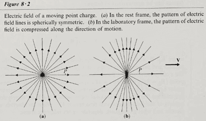

The question still lingering is the question in post #3 regarding the following excerpt from Ohanian:
There is disagreement on the interpretation of the last sentence. In the underlined sentence, is Ohanian still referring to (48) as applied to a charge in motion, or is he now assuming that the charge is at rest?
@shinobi20 and I believe that he is still assuming that the charge is in motion. We see him claiming that for points in front of (or behind) the moving charge, the E field is the same as if the charge were at rest. This claim is false as can be easily seen by examination of the first equation in (48). It's probably just an oversight on Ohanian's part.
Others believe that in the last sentence he has switched to assuming that the charge is actually at rest. But if so, why would he bother to include the phrase "..directly ahead of (or behind)..". Surely if the charge is actually at rest, then (48) reduces to the field of a point charge at rest at all points, not just points "ahead of (or behind)".
Eq. 48 is a general equation. It is still applicable even if the velocity of the charge is zero in the lab frame. What makes you think otherwise?
Again, it is a general formula—there is no “switching”. Why would he need to “switch” for ##v=0##, but not for any other velocity?
I agree, the word “directly” is a little misleading here.

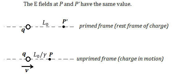

Here's a way to make sense of what Ohanian says.
Suppose we attach a thin rod of rest-length ##L_0## to the charge. The rod is oriented along the ##x## axis to the right of the charge. In Ohanian’s primed frame, the charge and rod are at rest. The field ##E’_x## at the far end of the rod in this frame is ##E’_x = \frac{q}{L_0^2}##. In the unprimed frame where the charge and rod are in motion, the rod is contracted to length ##\Delta x = \frac{L_0}{\gamma}##. From (48), the field at the far end of the rod is $$E_x = \frac{q}{(\gamma\Delta x)^2} =\frac{q}{(\gamma L_0/\gamma)^2} = \frac{q}{L_0^2} = E’_x$$
So, the field at the far end of the rod is the same in both frames. That is, the field at a point in front of the moving charge is the same as the field in front of the charge when it is at rest if you choose the distance in front of the moving charge to be the Lorentz contraction of the distance in front of the charge in the rest frame.
If that's what Ohanian means, then I'm OK with it. But it still appears to me that his equation ##E_x = \frac{q}{(x-x_p)^2}## at the end of the last sentence should be ##E_x = \frac{q}{\gamma^2(x-x_p)^2}##.
Originally, it seemed to me that he was saying that if you go to the unprimed frame where the charge is in motion and you measure the field, say, 1 meter in front of the charge (measured in the unprimed frame) then you will get the same field that would exist 1 meter from the charge as measured in the rest frame of the charge. That wouldn't be right.
Whew.
[EDIT: A picture might help]
TSny said:
... if you choose the distance in front of the moving charge to be the Lorentz contraction of the distance in front of the charge in the rest frame.
I’m disinclined to believe this is what he meant simply because relativity is all about distinguishing between frame dependent quantities and frame independent ones. The electric field is frame dependent, so it doesn’t really make sense to say that it’s independent as long as you change what you mean by x=1 depending on your frame.
But upon re-reading the paragraph, I was suddenly able to see the source of confusion. I still think he’s just wanting to point out how the equation reduces to the familiar inverse square law equation, but I’m less sure than I was.
I think we can all agree now, however, that it’s a weird and confusing sentence—the important thing is that we do understand relativity well enough to figure out ways of forcing it to make sense.
It is interesting that if you have a region of electric field and if some event occurs in that region, then the x-component of the electric field at that event will have the same value for any frames moving relative to each other in the x-direction: ##E'_x = E_x##.
This fact is related to the picture I posted in my last post, where ##P## and ##P'## can be thought of as marking the position of the same event.

If he actually switched to assuming that the charge is now at rest, there wouldn't be any point to it right? Assuming he already established a rest frame for the charge, which is so.
It is a general equation for the E-field as viewed in the lab frame where the charge is moving, which was the original setup.
I don't think the word directly is misleading, I totally get what he wants to say there, it is the equation in the last sentence in combination to what he wants to say that is misleading.
TSny said:
I never meant to imply that (48) is not applicable to v = 0. The question is whether or not in the last sentence of the paragraph Ohanian is assuming that v is zero.
Equation (48) is for any v < c. I believe Ohanian is still assuming the charge has any v < c in the last sentence. That is, he hasn't suddenly "switched" to assuming the charge has v = 0. Rather, he seems to be saying that while the charge is moving at any velocity v, the field in front of (and behind) the charge is the same as for a charge at rest.
Exactly my point to @Pencilvester
Whew.
This confirmation is what I'm waiting for, so can I say that the equation in the last sentence has a typo, that is, it must have a ##\gamma^2## in the denominator? Actually I think this must not complicate further as I think it is just a plain typo, I totally understand what is happening until this suspected typo. BTW, how did you draw that diagram? Thanks for the effort!
Yes, that's how I see it.
I used Microsoft Paint.
I'm not sure, whether I understand this enigmatic sentence by Ohanian either. Note that in my notation
$$u \cdot x=\gamma (c t-\vec{v} \cdot \vec{x}).$$
Thus in the denominator in my [1] equation (3.6.9) you have
$$(u \cdot x)^2-x \cdot x=\gamma^2 (ct-\vec{\beta} \cdot \vec{x})^2-c^2 t^2 + \vec{x}^2.$$
"Directly ahead or before" the charge, I'd interpret as at a position ##\vec{x}=(v t+\epsilon) \vec{\beta}/\beta##
Then the expression in the denominator gets
$$(u \cdot x)^2 -x \cdot x = \gamma^2 \epsilon^2$$
Then indeed
$$\vec{E}=\frac{q \gamma}{4 \pi} \frac{\vec{x}-\vec{v} t}{[(u \cdot x)^2-x \cdot x]^{3/2}}=\frac{q}{4 \pi \gamma^2 \epsilon^2} \frac{\vec{\beta}}{\beta}.$$
Thus there's an additional factor ##1/\gamma^2## compared to the expression at rest.
The electric field of a charge moving with velocities close to ##c## is sharply peaked in transverse direction (with the longitudinal component suppressed by the said factor ##1/\gamma^2=1-\beta^2##.
[1] https://itp.uni-frankfurt.de/~hees/pf-faq/srt.pdf
shinobi20 said:
there will be no point of writing ##E'_x## (equation above (48) which is clear to be the E-field for a charge at rest) and another more general field ExExE_x which as you claim reduces to the "charge at rest", why write prime and unprime then if the other is just a special case of the more general, also knowing that we use prime and unprime for different frames?
##E’_x## is defined to be the E field in the charge’s own frame, using the charge’s own coordinates. So it doesn’t matter whether or not the charge is moving in the lab because it can always consider itself to be at rest. Eq. 48 does not reduce to the equation at the top because you’re using different coordinates—you’d need a coordinate transformation for that (which happens to be a simple translation if you assume ##v=0##). So the reason they write prime and unprime is to distinguish which frame you are considering the E field in.
shinobi20 said:
Again, ##E'_x## and ##E_x## are fields viewed from different frames so you cannot just compare it the way you compare it.
You’re right, in post #10 I was sloppy with my phrasing. I though I fixed that before hitting Post, but I guess I didn’t. It should have said “Anything at rest in a given frame has gamma equal to one.”
shinobi20 said:
If he actually switched to assuming that the charge is now at rest, there [would be no] point to it right? Assuming he already established a rest frame for the charge, which is so.
Not necessarily. ##v=0## for a given particle in a given frame does not imply that the coordinate transformation to get from said frame to the particle’s frame is the identity matrix. There is still the possibility of translation and rotation.
By the way, I’m not meaning for what I’m saying here to support Ohanian’s weird words or even my own forced interpretation of what he may be trying to say. I’m just trying to reveal some subtle assumptions you may be making. I do agree now, whatever Ohanian was trying to convey, he did it poorly.
shinobi20 said:
so can I say that the equation in the last sentence has a typo, that is, it must have a γ2γ2\gamma^2 in the denominator?
At this point, I don’t think it matters how you make sense of it—there are going to be problems no matter what. If you just assume a simple typo of a missing gamma squared, then you have the problem of trying to explain the phrase “... the electric field is the same as that for a charge at rest; that is...” One, there’d be no need for gammas in an equation for something at rest, and two, that whole statement is just plain wrong. Assuming non-zero velocity, they’re not the same. In my case, I have trouble explaining ”the electric field is the same as”. You’re right in that he makes it sound as though he is referring to the electric field around a charge with possibly non-zero speed (or definitely non-zero, depending on your assumptions), and again, that would be wrong.
I think what Ohanian is saying in the last sentence is correct, it is just that the equation in there lacks the ##\gamma^2##.
This is also taken from Ohanian,
So the fields parallel to the direction of motion are indeed the same with respect to Lorentz transformation, which is what he is saying in the last sentence.
Well, but what he forgets is that you have to transform both, the field components themselves (the fields are of course invariant under Lorentz transformations as any tensor) and the spacetime argument. In covariant form
$$F_{\mu \nu}'(x')={\Lambda^{\mu}}_{\rho} {\Lambda^{\nu}}_{\sigma} F^{\rho \sigma}(x)={\Lambda^{\mu}}_{\rho} {\Lambda^{\nu}}_{\sigma} F^{\rho \sigma}(\hat{\Lambda}^{-1} x').$$
The electric field of a moving point charge with speeds close to ##c## is almost transverse to the direction of the particle's velocity, i.e., it is very different compared to the isotropic Coulomb field of a charge at rest.
The lesson is: Don't make to many words about formulae which speak for themselves!
That's a very standard result, but some care most be taken in it's interpreation.
The cleanest way to interpret the above is that if one has two E and B field meters at the same event in space-time, the above relationship tells you how the meter readings transform.
To use this to find the field of a moving charge takes a bit of thought. One way of doing this is to imagine a moving charge, and a co-moving E-field meter. They are in some inertial frame, that I'll call the red frame. We'll call the lab frame the green frame.
In the red frame, the charge has a coulomb field, that we can write down. And that's what the red meter will read.
Knowing the above transform law, we can find the fields in the green frame, but we have to be careful to do it correctly.
In order to fiend the field in the green frame, as a function of the green coordinates, though, we can start by considering some green coordinates (t_g, x_g). Then we convert these coordinates via the Lorentz transform to the red frame, (t_r, x_r). We've already noted that columb's law gives the meter readings in the red frame. The last step is to convert these meter readings using the above transformation law to get the green meter readings.
This is essentailly what Vanhees wrote above, in tensor notation, which is the easiest way to do it. If one is not familiar with the tensor notation, one can work through it carefully, but the tensor approach is easier.
Not that the distance from the charge to the meter will be different in the red and green frames. The simultaneity conventions will also be different in the red and green frames. So to avoid errors and get all the correct factors of gamma as the textbook does, one has to be careful not to skip any steps, and work through the above procedure exactly, using the Lorentz transforms.
