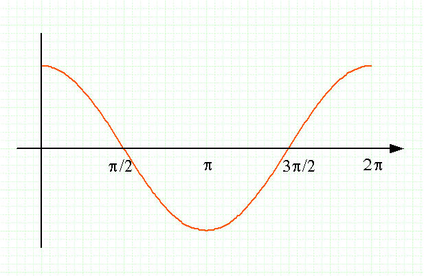

I understand that the dE_x vectors both point in the +x-direction, but if I put in the integral of cosΘdΘ over the interval ∏/2 to ∏ on my calculator it is giving me the answer of -1. The answer is positive one for an interval of 0 to ∏/2, but I've been looking at the second quadrant for the entirety of the problem so far and would like to stay consistent.
Take a look at the area under the curve of cos(θ) from ##\pi / 2## to ##\pi##. Is it positive or negative?
A sneaky fix to change the sign is to exchange the two limits of integration: integrate from ##\pi## to ##\pi / 2##.
