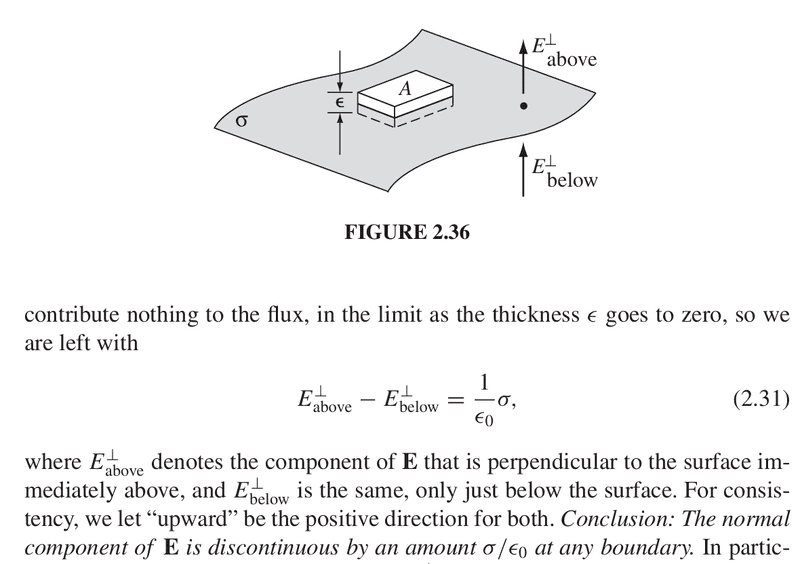

kuruman said:
When you get to boundary conditions, you will see how the one described above is a direct consequence of Gauss's Law. I am sure you can find its derivation in Griffiths if you look for it.
I don't exactly follow this equation. "Upward" is the positive direction for both by definition. Fine. Gauss' law states that flux = E dot A. For the flux above ##\sigma##, both E and A are positive. So E_above is positive, which agrees with the text. However, for the flux below ##\sigma##, both E and A are negative. So why isn't E_below positive?
The reason why I think it should be E_above + E_below is: recall when you have a flat sheet of surface charge. The total flux is E_above + E_below. Why isn't in the same here?
Ah I think E_below is negative so it's fine?
No. The negative sign comes from the surface normal being in the negative direction for the surface below.
Reply
Are they not equivalent situations?

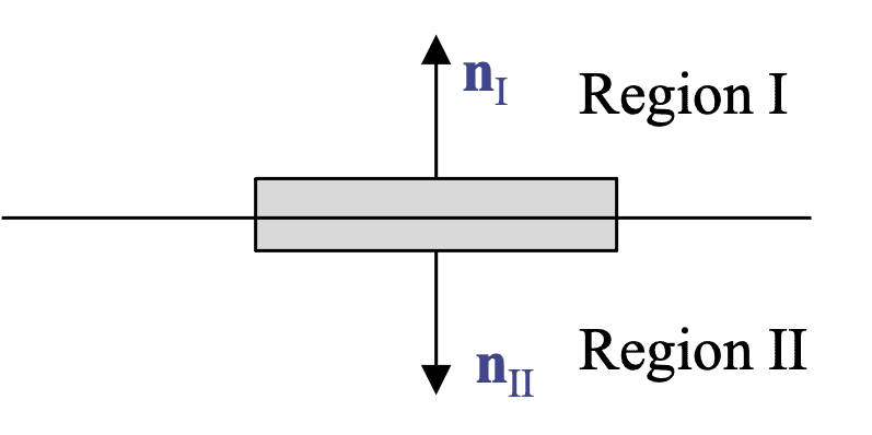

You are missing the information that when you have a Gaussian surface, the normal to it is always outward. Consider the pillbox shown on the right. Only the flux through the top and bottom flat surfaces need to be considered in the limit that the pillbox shrinks to zero thickness. Note that the unit normals point in opposite directions, ##\mathbf n_{\text{II}}=-\mathbf n_{\text{I}}.## Then $$\Phi_{\text{total}}=\Phi_{\text{top}}+\Phi_{\text{bottom}} =\mathbf E_{\text{I}}\cdot \mathbf n_{\text{I}}~\Delta A+\mathbf E_{\text{II}}\cdot \mathbf n_{\text{II}}~\Delta A=(\mathbf E_{\text{I}}-\mathbf E_{\text{II}})\cdot \mathbf n_{\text{I}}~\Delta A=(E_{\text{I,n}}-E_{\text{II,n}})\Delta A. $$ That's how the minus sign comes into the picture.
kuruman said:
$$(\mathbf E_{\text{I}}-\mathbf E_{\text{II}})\cdot \mathbf n_{\text{I}}~\Delta A=(E_{\text{I,n}}-E_{\text{II,n}})\Delta A. $$
I don't follow this step. Why isn't ##\mathbf E_{\text{II}} \cdot \mathbf n_{\text{I}} = -E_{\text{II}}##? In your diagram, ##\mathbf E_{\text{II}}## points down. And ##\mathbf n_{\text{I}}## points up.
It is ##E_{II,n}## not ##E_{II}## - the component of ##\vec E_{II}## in the direction of ##\vec n_I##. This is by definition ##\vec E_{II}\cdot \vec n_I##.
Ah, I see. This does mean that ##E_{II,n}## is a negative number, right? As they are always in opposite directions.
Huh? No. There is no requirement that the field points in any specific direction.
Ah I think I see my misconception. Usually when doing these Gauss' law questions the flux is just ##2EA=\frac{\sigma A}{\epsilon_0}##. But when doing this I assumed that sigma was positive. However, I see now that sigma could just as well be negative, leading to ##-2EA=\frac{\sigma A}{\epsilon_0}##, which is also valid, as ##\sigma## would be negative.
When writing ##2EA=\frac{\sigma A}{\epsilon_0}## in future, should I be more careful and say that this equation is only true if ##\sigma > 0##? And if ##\sigma < 0##, then ##-2EA=\frac{\sigma A}{\epsilon_0}##.
Edit: I guess we could also just treat E as a signed quantity and use one formula.
No, you have some serious misconceptions here. You seem to be thinking only about a field caused solely by an infinite flat sheet of constant surface charge. However, this is originally about a sphere and, more generally, about the field boundary conditions near any surface charge. You cannot assume a particular form of the field and the result is a discontinuity in the field component normal to the surface and proportional to the surface charge density at that point.
