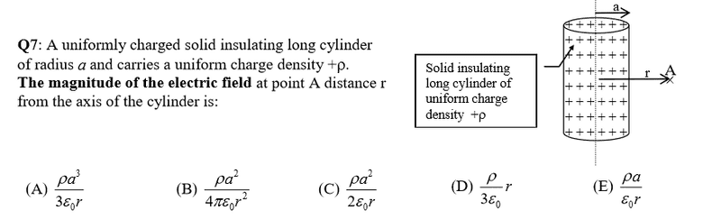

Can someone tell me where is my mistake ?

You are using the volume of a sphere instead of the volume of a cylinder.
You should draw the Gaussian surface for which you are calculating the charge enclosed.
