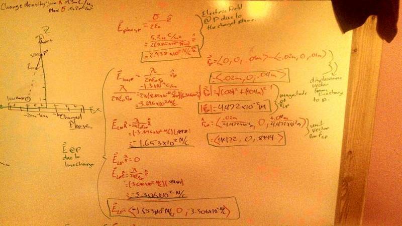

Blah Blah irrelevant context.. positively charged plate occupying the x - y plane with charge density ##σ=5.2{\frac{nC}{m^2}}##.This maybe modeled as an infinite charged plane. There is a Charged wire running parallel to the y-axis through the point ##(-2.0cm, 0, 1.0cm)## The wire can be modeled as an infinite linear charge and carries a negative charge of ##λ=-1.3{\frac{nC}{m}}##. Compute the electric field at point P at ##(0,0,5cm)##. Draw the electric field vectors from each object and the total electric field at point P.
I got final answers that could be in the right direction, but something seems off.. Am I doing this right, do the values seem correct?
Note: In the attached pictures, I've labeled in green what each step is and underlined in green important values, and then put green boxes around final values. The black is just my correcting a mixed up sign.
See attatched Pictures
See attached pictures.
Here are the pictures, it wouldn't let me post them in the op for some reason.
  • Handwritten whiteboard derivation of the electric field at point P from an infinite charged plane and an infinite line charge, with vector components and boxed results; a small sketch shows the plane and line.
  • Handwritten whiteboard working in red and black ink: E-field due to a line charge at point P, with vector components summed by superposition with the plane-charge field, giving a total E_P vector with numeric components in N/C.
