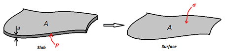

In general, consider a thin slab of material of thickness d that has a uniform volume charge density ρ. If you approximated this by a surface with an "equivalent" uniform surface charge density σ, how would you write σ in terms of ρ and d?
Diagram of a thin slab of area A and thickness d with volume charge density rho, with an arrow pointing to an equivalent flat surface of area A with surface charge density sigma.

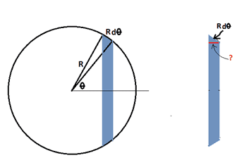

For one of the thin disks of the sphere, how would you write the thickness |dx| of the disk in terms of R, θ, and dθ?

ρ . A . d = σ . A
ρ . dx = σ

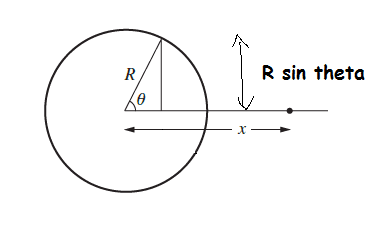

Is this what you were implying?I don't see how R sin θ dθ equals the thickness of my disk, since R sin θ points in the direction perpendicular to the x-axis.

Yes.
http://blob:https://imgur.com/7c67520c-b11f-4fb3-9218-afcca75d1bf7
Circle of radius R centred on a horizontal axis, with a radius drawn at angle theta, a vertical line from the circle down to the axis labelled R sin theta, and a horizontal distance x marked from the centre to a point on the axis.
See if the following diagram helps. The red line in the right figure indicates the thickness of the disk. Note that the red line is also the base of a small right triangle at the top of the disk where R dθ is the hypotenuse. See if you can find the length of the red line by using trig on the right triangle.
