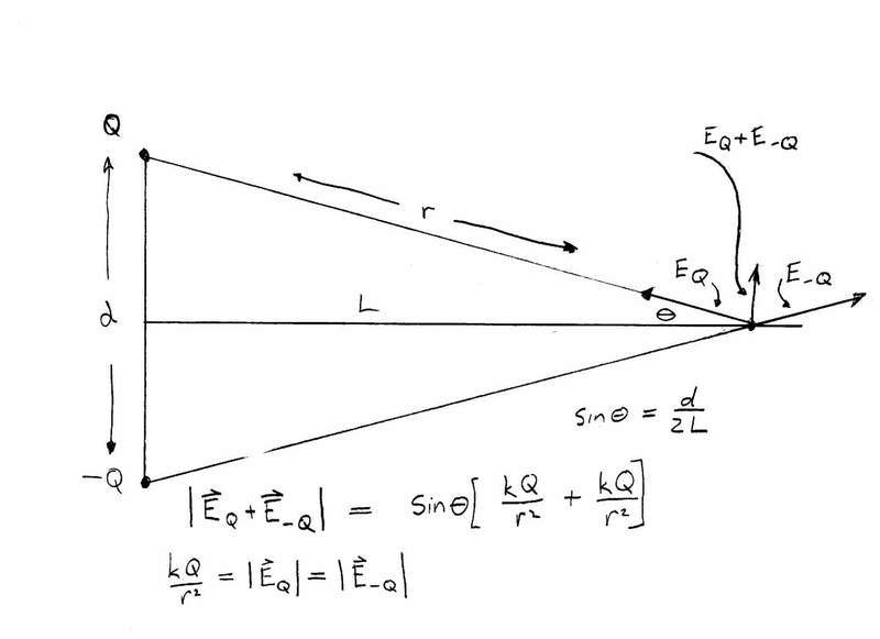

Two equal and opposite charges form a dipole, as shown in the figure. What is the magnitude of the electric field at point P, in terms of k,q,d, and x? If point P is VERY far away, show that the result is approximately E = kqd/x^3.

I don't know how to start? Does the dipole basically act like a wire?

Maybe this will help.
Thanks, now I know where the forces are going. But why is sin(theta) = d/2L? shouldn't it be cos(theta) since L is the adjacent side?
Can't we use the Pythagorean theorem to get that r = sqrt(L^2 + (d/2)^2) ?
My mistake, should be sin(theta) = d/2r. As r gets large sin(theta) gets small as required, the forces tend to cancel to a greater extent.
THANK YOU SO MUCH! I FIGURED IT OUT :)
