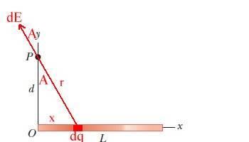

A uniformly charged rod of length L and total charge Q lies along the x-axis as shown.
Find the components of the electric field at the point P on the y-axis a distance d from the origin.
There's also a part b but I should be able to figure it out easily enough.

Mark off a small piece of the rod and label it dx, and its charge dq. You can express dq in terms of dx, the length L and the total charge on the rod.
Write the formula for the dE caused by dq at point P. Integrate it over the length of the rod - the integral will look very much like the equation your posted.

I'm looking over the video he did, and he added a cos(theta) in the integral (his reasoning being "this needs to go here"). I'm assuming I will need something like that to show the change in the angle, but not sure where.
Good catch! I forgot about the angle. Both the "r" in E = k*q/r² and the direction of dE depend on the angle A. (Sorry, can't make a theta in my paint program.)
You can avoid the first; just express your r in terms of d and x.
Unfortunately there is no symmetry in this problem to cancel out the horizontal part of the field. You can't add contributions to the E field in different directions, so you will have to do the horizontal and vertical components of E separately, with two integrals. One will have a cos A and the other a sin A factor. This brings up another difficulty. The x, r and A all vary! Too many variables. You'll have to pick one for dx, dr or dA and express the other two in terms of the one you choose. I kind of like x for the variable, but it does make cos A and sin A a little awkward. Hope you have an integral table handy. Or www.integrals.com.

I have dE = kdq/r², dq = q/L*dx, cos(A) = d/r
For the vertical component of E, use dE*cos(A) = kqd/L/r³*dx
The vertical component of E is kqd/L Integral of dx divided by (x² + d²)³/²
