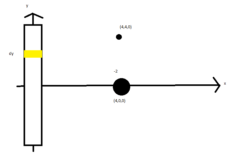

There is an infinite charged plate in yz plane with surface charge density ##\sigma = 8*10^8 C/m^2## and negatively charged particle at coordinate (4,0,0) Find magnitude of efield at coordinate (4,4,0)
E= E1+E2
So I figured to get e-field at point (4,4,0), I need to find the resultant e-field from the negatively charged particle and the plate
##E_{resultant}=E_{particle}+E_{plate}##
##E_{particle}=\frac{kq}{d^2}=\frac{(9*10^9)(-2*10^-6)}{4^2}=-1125N/C##
Now for the plate is where I'm confused.
If this was a wire, it would have been okay for me since I only need to deal with one dimension.
Since what they requested was a plate in yz plane, does this means that my:
##\sigma=dy*dy*x?## where ##dy## is the 'slice' I take and x is the width of the plate? Is that accurate?

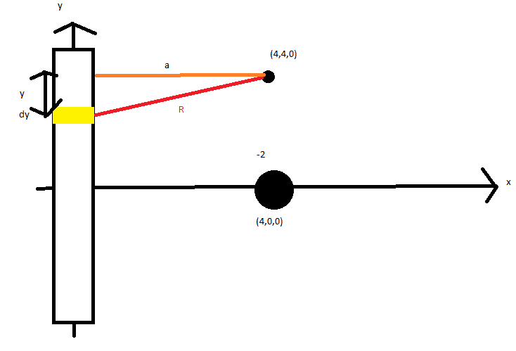

If it is true, then to find the e-field created by that slice at the point,
##dE=\frac{kdq}{R^2}##
##dE=\frac{k\sigma *x*dy}{a^2+y^2}##
I know that the vertical components of the resultant e-field will cancel out because there are same amount of segments on top and below the point.

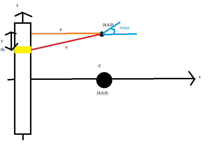

So need to find ##dE_{x}##, which = ##dEcos\theta##, where ##\theta## is shown:
So ##dE_{x} = dEcos\theta = (\frac{k\sigma *x*dy}{a^2+y^2}) (\frac{a}{\sqrt{y^2+a^2}})##,
Now the problem is I can't integrate this to find my resultant e-field because I do not know what the value of x is. If this was a wire in a plane it will have been solvable for me, but now I'm kind of stuck.
Any clues/help? Thanks :)

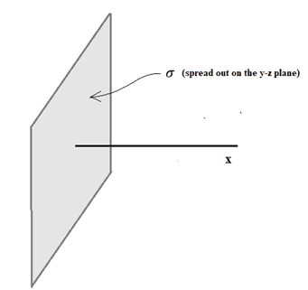

I'm not sure you are picturing the charged plane correctly. The surface charge density σ is spread on the y-z plane. You do not need to worry about any thickness of the plane.
The electric field of a uniformly charged infinite plane is a standard problem. Are you sure you haven't already covered the formula for calculating E due to the plane?

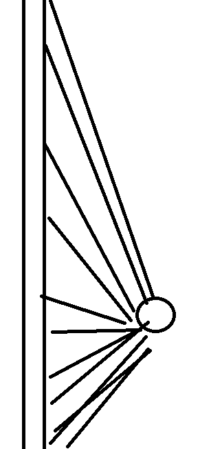

Spreading around the plate?
It's infinite. There is no around.
Which way would a point charge with the same sign as the plate's charge move?
Repel, since they have the same charge
Yes, but in exactly what direction relative to the plate?

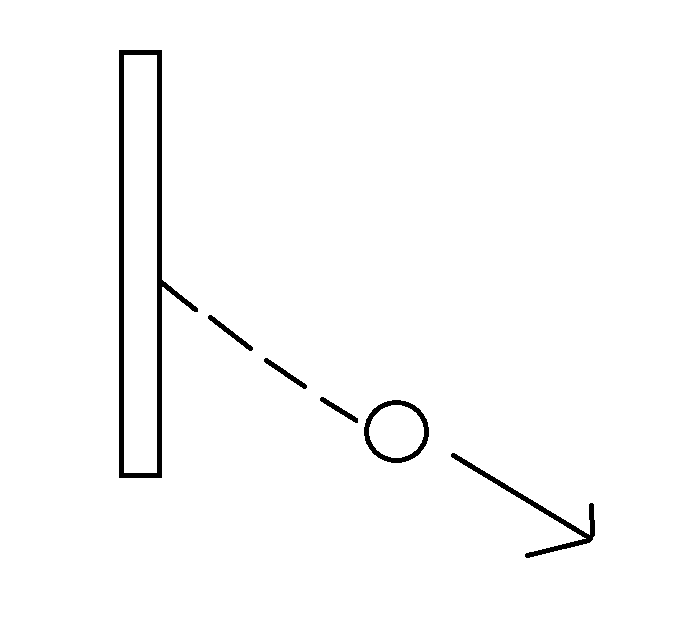

Not sure what you meant, but won't it repel away from its point? for eg:
It is an infinite plate. Why would the repulsion be down (in terms of your diagram) rather than up?
Pardon for messy drawing, but if I'm correct, the charge particle simply repels to the right right? Since the vertical components are pretty much canceled out
