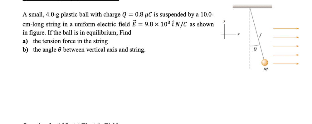

A small, 4.0-g plastic ball with charge Q=8uC,is suspended by a
cm-long string in a uniform electric field ⃗ E=9.8x10^2 in figure. If the ball is in equilibrium, Find
a) the tension force in the string
b) the angle between vertical axis and string.

In addition to showing your work, please try again to attach the diagram of the problem. How many cm long is the string?
This is the question
Ah, that helps. Okay, please show us your free body diagram (FBD) for the plastic ball, and write the equation for the force of the electric field on a charged body (it is similar to the equation you wrote for the electric field from a charged particle above). Please show us your work. Thanks.

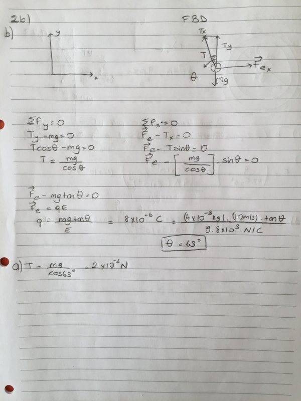

I'm not sure about the solution.If there is any mistake,please show it.Thanks :)
It all looked good until you came to the calculation. Why didn't you do:
$$\tan \theta = \frac{qE}{mg}$$
You made a mistake writing down the charge, which is ##0.8 \mu C##.
One minor point is that you shouldn't mix vectors like ##\vec{F_e}## and scalars like ##T_x## in the same equation.
Ok,are the answers are correct,I would be happy if you answer
It's wrong because you used the wrong charge.
