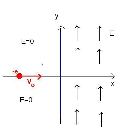

The y-axis marks the boundary between the area where the is no electric field (in the second and third quadrant) and the area where there is a constant electric field: E = 610j N/C (in the first and fourth quadrant).
An electron travels along the negative x-axis toward the origin at vo = 7.04i Mm/s, and then it enters the electric field.and changes direction. Find the y-coordinate of the electron, in cm, when its x-coordinate is 92.3 cm.

First make a drawing: A coordinate system, and indicate the region with E=0 and E = 610j. Show the electron traveling along the negative x-axis towards the origin with velocity v0 = 7.04i Mm/s.
What force acts on the electron when it is in the electric field?
Diagram of a coordinate system with a vertical blue line at the y-axis; left of it E=0, right of it upward-pointing arrows labelled E. A red dot labelled -e moves right along the x-axis with velocity v0.
This is exactly analogous to a projectile fired with a horizontal initial velocity v0, with the E field, like gravity, acting in the -j direction (no air resistance assumed, as usual). The E field is equivalent to gravity.
BTW in this problem, mass of the electron is ignored. The force is electrostatic only.
I think you meant that gravity is ignored.
