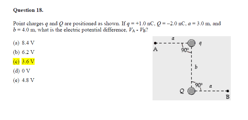

Point charges q and Q are positioned as shown. If q= +1.0 nC, Q = -2.0 nC, a = 3.0m, and b = 4.0m, what is the electric potential difference, Va - Vb? **The question with the diagram is also attached **
V = ke (q/r)
V = (8.99x10^9)[(1.0x10^-9)/4) = 2.2475 V.
The anser is 3.6V though, so I don't understand what I am doing wrong!
You are computing the electric potential at the -2 nC charge resulting from the other. This is not what is being asked for.
How would you compute the potentials at the points A and B?
How would you suggest to go about it? Because I tried it with the -2.0nC as well and i still didn't get the right answer :/
What you are trying is not what is being asked for.
How would you compute the potential at the point A resulting from the upper charge?
what do you mean by the upper charge?
The upper charge in your image is the 1 nC charge.
The potential at that point would be V=ke(q/r), where q is the 1 nC charge and r is a?
Yes. So what would be the potential at that same point from the other charge?
In the same fashion, what would be the potential at B from both charges?
So the potential at A is V= (8.99e9)(1e-9)/3 = 2.9967 V. The potential at B is V= (8.99e9)(-2e-9)/4 = -4.495 V?
No, you need to compute the potential at both points using both charges and the correct distances.
I'm sorry but I am quite confused right now and I really don't understand how to go about this question! Do you mind explaining conceptually why i have to find the potential at each point for both charges?
Because both charges contribute to the potential at both points and you are interested in the potential difference between the points. The situation is not that of a single point charge.
Oh that's what I was forgetting, thank you! It makes so much more sense now! :)
