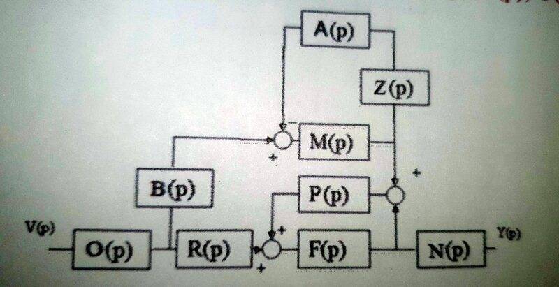

I am having a problem with calculating transfer function given with a picture below i need to calculate output Y(p) / input V(p) analitically but i dont know how to do it
Thanks for any help or comment

You should show some work and then we can give hints. Replace feedback loops with single blocks. To do that, you might need to split off some feedback loops (F,P) from feed-forward paths (B,M,P). Replacing the feedback loops will leave you with only feed-forward paths which should be easier to deal with.

I know how to solve this problem grafically, but this problem i need to solve analitically, without reducing loops.

I'm not sure exactly what "analytical" means in this context. However, you could do it using brute force. Give a name to every node and just write out all of the equations relating them. You'll have a bunch of "analytical" equations, that you can reduce to a solution.

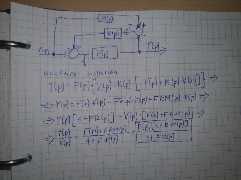

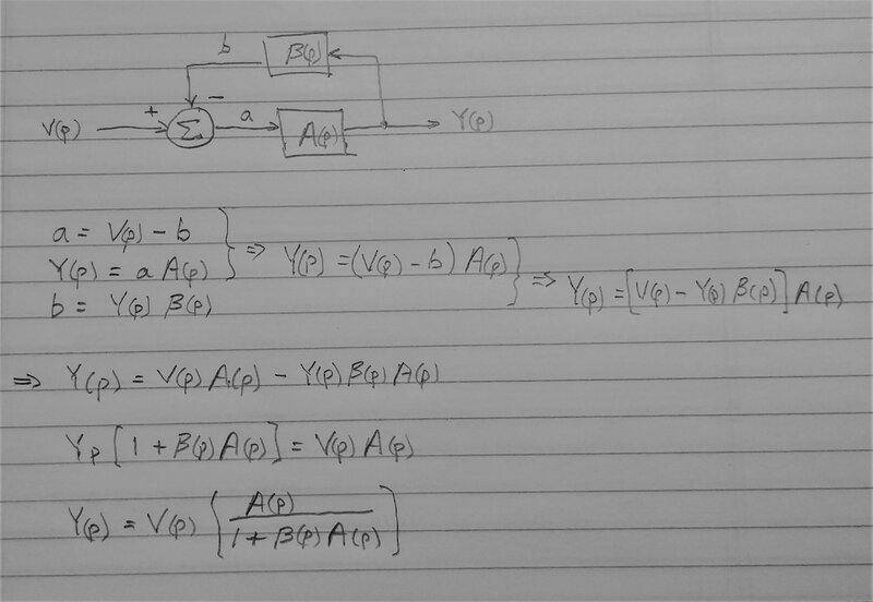

Here is the example solved analitically
Ok. What you are calling graphical manipulations are mirrored by analytical, symbolic manipulations. Reducing a feedback loop to a single block is expressed analytically. The single block replacement of the feedback loop has an analytical expression in it. The process of the graphical solution can give you the steps to get the desired analytical expression.

Here is the example solved analiticallyView attachment 291213
This example is only a little less complicated than your original problem. Is this your work or a copy of a worked example? I'm a little confused about what your problem is, please explain what confuses you and show an attempted solution. We can't help if we don't know what part is confusing you.
Below I've shown an analytical solution to the trickiest part of these networks. Notice that I've given arbitrary names to the internal nodes that weren't already named. That allows us to construct one equation for each block. In the example above, you will have 5 equations. After you have those equations you eliminate all of those internal variables by substitution.

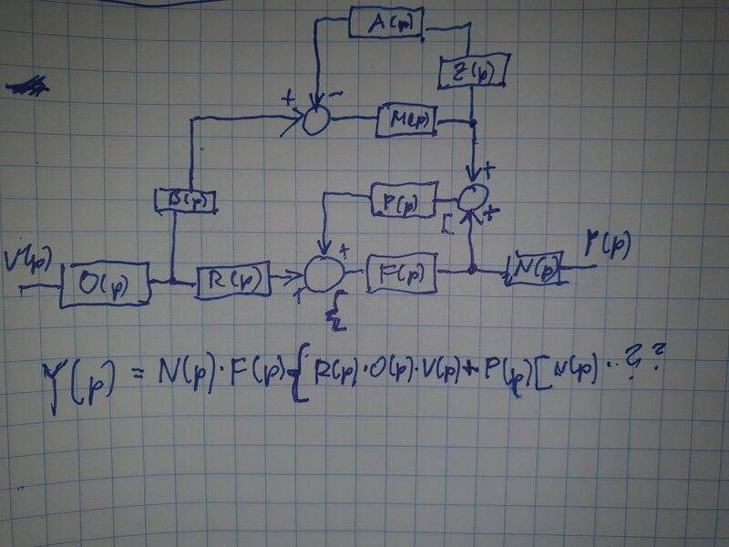

Here is my attempt for trying to solve TF analitically, i dokt know what to do after that second sumator.
These can be very hard to write down in one step. That is why I would recommend an analytical approach of a few simpler steps.
1) Replace the M->Z->A feedback loop with a single block, M' = M/(1+AMZ)
2) Duplicate the P block so that there are two separate paths: a forward path M'->P->F and a feedback loop, P->F->P. Then replace the second loop with a single block, F' = F/(1-PF).
3) Now you have only forward paths with no loops and can just sum and multiply them at the appropriate places.
@DaveE 's post #9 shows a more methodical approach that would help greatly in complicated examples.

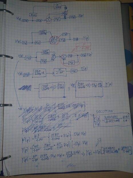

I have solved this problem, but i don't know if it is correct, can you please tell me if i am right. Thanks for support.
I have trouble reading the details, but I think that I agree with it.

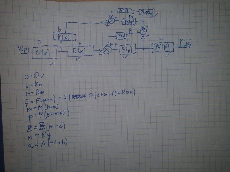

I'm thinking about steps for solving this step analytically but i don't really know the othher equations in order to calculate output/input here are the equations that i was given
What about p=P(z+m+f)? This must be done methodically. Label each signal on a diagram and make sure that you have an equation for each one. Do not try to keep track of too much in your head, it will frequently lead to mistakes.

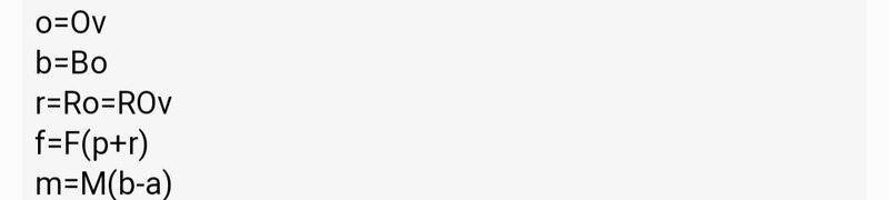

How do i write equation for output then, even if i wrote for a correctly, i cannot resolve for output signal n = N * y, its only one equation
This approach will only work if you are very systematic about your labels. You don't need an 'n' for the output of the N block because that is Y. And 'f' is the output of the F block, not the input. Then you start with Y= fN and start replacing things: Y=(F(p+r))N. Now I see that there are confusing labels and equations. I think you need to check all the labels and equations before you can proceed.
But i need to write Y(output)/V(input) function, these equations are very confusing.
Y= fN = (F(p+r))N = F(P(z+m+f)+ROv)
p=P(z+m+f)
r = Ro=ROv
b = Bo=BOv
o = Ov
f = F(p+r)
m = M(b-a)
a = A ?
z = Z ?
Can you please show me the solution for a and z, thank you, this methodical way is quite hard.

I think you can not proceed until you check a few things:
1) Do all your signal labels like 'p' refer to the OUTPUT signal of the P block? I think you have a mixture, which is bad.
2) After completing (1), check all your equations.
Why do i need to refer all signals to the output, if i refer them to the output then i won't have any equations for the input and i won't be able to calculate Y/V
The only difference between the equation of the input and the output signals of block 'X' is the X multiplier. If you have a mixture of labeling inputs and outputs, then you run the risk of missing one of the block multipliers from your equations. I tried to give you a hint of how to work with your equations but I think I ran into a missing block multiplier.
