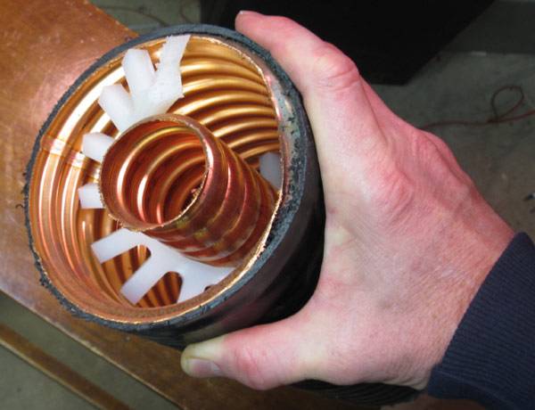

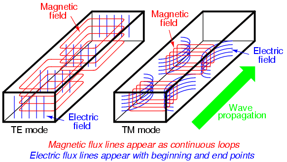

Thank you anorlunda for your very clear explanation, that's why the quality of the dielectric in a coaxial cable, support for high frequency energy, is very important. Moreover, under your control, at ultra high frequency, several Ghz, the central conductor become unnecessary, it is called in this case the waveguide
yes indeed, because the energy is transmitted in the electric field around the conductor. and that is why the type of dielectric is important.
Very low loss coax cables use as little amount of solid dielectric as possible. Many use a thin Teflon spiral which its main purpose is to
keep the centre conductor and the outer conductor from touching each other. Most of the dielectric is air.
Yup, so then you only have the outer shield which constrains the electric and magnetic fields
