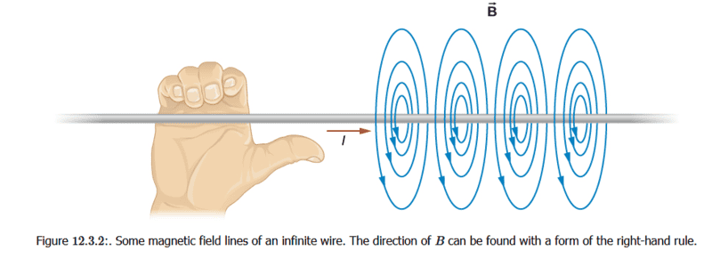

Hello,
Assuming that we have a single-phase electrical transmission line (short distance (< 50 km), stranded, non-isolated, made of aluminum conductor steel reinforced), I would like to know the resulting magnetic field (shape, structure, absolute value, and all other possible details) when the line is being injected by different RMS values of an AC current of 50 Hz. It is intended to have a mathematical model formulation of the resulting magnetic field, so that it is possible to know the Tesla value of the magnetic field directly when the RMS value of the injected current is known.
In other terms, the required solution shall be as follows: a mathematical function that has the current's intensity (in Amperes) and frequency (in Hertz), in addition to the cable's length and geometry (thickness, number of stranded wires, etc.) as inputs, then consequently outputs the magnetic flux density (in Tesla) at an arbitrary point in the space near (around) the current carrying conductor (i.e., stranded-wire).
Suppose that the stranded wire lies (coincides) on the x-axis in a Cartesian plane; this wire begins at (0;0;0) and stretches forward the positive x-axis until its length: what would be the flux density at a point P (x;y;z) located in the same plane, that has the following coordinates:
x = 1 meter
y = z = 0.15 meter
Thank you in advance

If it's 3-phase, there are 3 current-carrying conductors. So you would use the Biot-Savart Law to calculate the vector sum of the 3 B-fields at your points of interest.
https://phys.libretexts.org/Bookshe...3:_Magnetic_Field_due_to_a_Thin_Straight_Wire

Well, if you have no math background this will be more difficult. My post #4 did contain equations that you can use to do this calculation. So you're saying you want someone else to do this calculation for you? Do you have anybody else working with you on this "project" who has more of a math background?

"Your" post #4 contains merely a concrete form of Biot-Savart law. If you carefully pay attention to the title "your" Fig. 12.3.1, "your" equation is ONLY valid for calculating the magnetic field emitted around a single straight wire.
I simply want to calculate the magnetic field emitted around a stranded wire composed of multi sub-single wires.
Without any mathematical knowledge, it is clear enough that "your" equations cannot be applied to my concern, which was stated clearly from the beginning of this post.
Thank you again

I believe one of the assumptions in the link in post #4 is that the wire is thin with respect to the distance away that you are measuring the field. In most situations (especially on the ground under powerlines), this is the case.

I did not fully understand the phrase: "is that the wire is thin with respect to the distance away that you are measuring the field". Would be greatly if you could kindly rephrase
It just means that we don't have to integrate over the thickness of the wire. You can see that the problem gets a lot more complicated if you are calculating the field at a distance from the wire that is on the same order as the thickness of the wire. If you are more like 100 wire thicknesses away instead, you can just assume that all the current is flowing in a single thin line.
