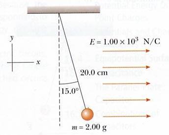

A small 2.00-g plastic ball is suspended by a 20.0-cm-long string in a uniform electric field, as shown in the below diagram. If the ball is in equilibrium when the string makes a 15.0 degree angle with the vertical as indicated, what is the net charge on the ball? If you can't see the diagram below, please go to http://students.washington.edu/cy1126/15.38.jpg
F = Eq
F = mg
I drew the free body diagram and identified three forces, weight, tension and electric force. Direction of the weight points down, electric force to the right and tension to the northwest. Since the electric force is parallel to the x-axis, we would not need to worry about the y direction. So my equation came out to be:
Fx = 1.00^3N/C*q - (0.002kg)(9.8N/kg)(sin 15)
0 = 1.00^3N/C*q - 6.70^-5N
q = 6.7*10^-8C
Okay, the number looks okay, but I feel like it's wrong. This is supposed to be a difficult problem, as marked in the book, but I solved it in one step. Moreover, I did not use the 20cm from the problem. Can anyone take a look at my calculation and see what I did wrong?

You need to consider forces in the y direction, so you can find the tension in the string. You did not take that into consideration in your solution.
I put the tension in the x direction into the equation already. I do not think there is a need to worry about the y direction because the electric field is on the parallel direction and so net charge on the ball only exists on the x direction
If you have your coordinate system defined as in the picture, the tension acts at an angle to that system. Therefore, the tension must be resolved into its components in the x and y direction. The electric field may only be in x direction, but the tension in the string is not only all in the x direction as well. Only a certain amount of it will be, and to find that amount, you must consider the forces in the y direction.
This term is not quite right. This is not the tension. Since gravity acts straight down (-ve y direction), there is no component of gravity in your x-direction.
To find the tension, you must sum the forces in the y direction as well. You will then have two equations with two unknowns.

Gocha, but I still did not use the 20cm part from the question. I did the way you suggested:
For the x direction:
1*10^3N/C*q - T*sin 15 = 0
For the y direction:
Tcos15 - 0.002kg*9.8N/kg = 0
Solution: T = 0.0203N
q = 5.18*10^-6C
I still have doubt about my answer. The problem looks more sense now, thanks to hage567, but I am still worried about the 20cm part. I never get to use that number in this problem

Sum of the Forces in the x-direction= Eq-Tsin(Pheta)=0
Sum of the Forces in the y-direction= Tcos(Pheta)-mg=0
T=(mg)/(cos(Pheta)
So sum of the forces in the x-direction=Eq-mgTan(Pheta)=0
q=(mgTan(Pheta)/E)
q=((.002)(9.81)Tan(15 degrees))/1000= 5.26X10^-6
I actually wanted to help in figuring this one out, but I think this old post gave me enough to go on. If anyone thinks what I did is wrong, please say so. Also, I agree the length of the rope is not important.
