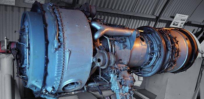

You can turn the fan of a big jet engine slowly round with one finger. But it takes maybe 50 MW of power to spin it up to say 3000 RPM and produce its maximum thrust.
To put 3.8m foot pounds in some sort of perspective, suppose you made a crank handle 10 feet long: you would have to apply about 170 tons of force to the crank to turn the generator.
That's one reason why gearboxes are a good idea for smaller wind turbines (because a gearbox plus a small generator running fast "wins" over a big generator running slowly), but eventually the gearbox has to be be so big that it becomes impractical. Even with a 20 foot diameter gearbox, you still have than 170 tons of force trying to snap off the gear teeth. Scale that down to a say a 4 foot diameter gearbox, and now you have 850 tons of force not 170.
This is what a gearbox that handles 5MW looks like - compare its size (the three sections of blue casings at the left hand side of the picture) with the jet engine that drives it. That gearbox spins runs much faster than a wind turbine, so the loading on the gears is much lower.
Photo of a large blue-grey turbofan jet engine on display, with its wide fan casing at left and exposed compressor and combustor sections at right.
( I can't find a good picture of what's inside the gearbox, but it looks more like "agricultural engineering" than "watchmaking".)
