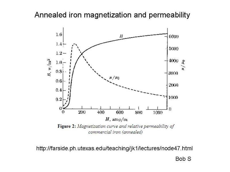

What is the shape of the 500 pound object you have to pick up? Does it have a flat surface bigger than the size of the magnet? Do you plan to machine the magnet iron core out of low carbon steel, or build it out of stock cold-roll? I suggest you think about using ~50 amps for 10 seconds-this will help determine the copper conductor size. It looks like you want ~400 amp-turns per meter. See thumbnail.
The simplest shape is a horeshoe electromagnet, , but it may not be the best.
Bob S
