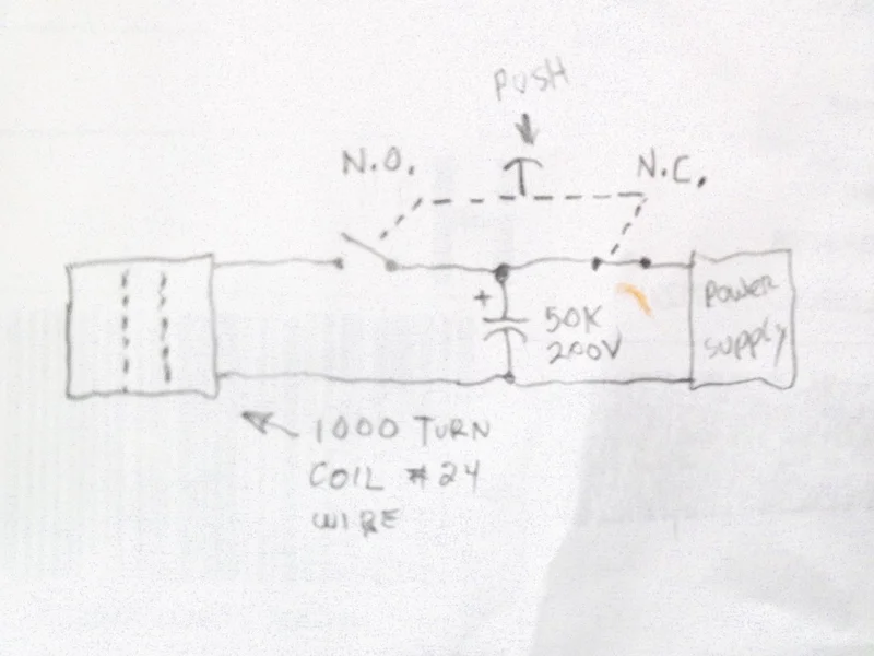

Do you know new magnets at the factory have no magnetic field until they are charged. Make a coil 1000 turns of #24 wire. Charge a 50,000. uf cap to 150 volts. Put magnet on the 1000 turn coil discharge the 50k cap into the coil. Very quick in 2 seconds test the magnets strength. If the magnet was able to lift 1 lb. after being pulsed with the 50k it might lift 200 lbs for about 4 seconds. The magnet has a 1/2 life of about 4 seconds. 200 lbs will become 100 lb in 4 seconds, then 100 lb becomes 50 lb in the next 4 seconds. Then 50 becomes 25 lb and 25 becomes 12.5 lb and so on. It takes about 20 minutes for the magnet to become normal again.
