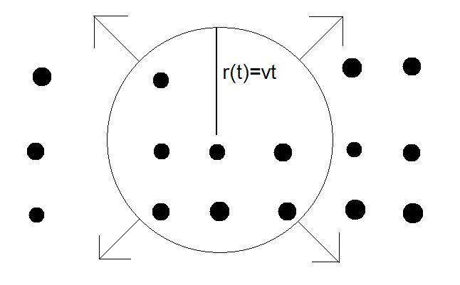

A circular loop with resistance 0.5 [tex]\Omega[/tex] per meter of length is placed in a homogeneous magnetic field of induction B=2 Teslas. The magnetic field is perpendicular with the surface of the loop, as shown in the picture (image1). The radius of the loop is increasing according to the equation [tex]r(t)=vt[/tex] with [tex]v=0.5 m/s[/tex]. What is the induced voltage at time [tex]t=10 s[/tex]?

EDIT: Forgot to put the image in the attachment, think it works now.
