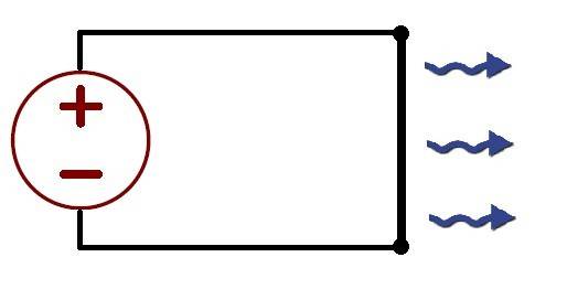

Say I have this setup:
...and the DC source is increasing at a rate of 1 V/sec. The electrons are being accelerated in one direction and will emit EM radiation.

proxy.php?image=https%3A%2F%2Fimagizer.imageshack.us%2Fv2%2F514x272q90%2F923%2F6ebNCa.png
With that definition, it isn't a steady DC source any longer, as you change the voltage the current will also change through the load
Once the applied voltage stops changing, then it will reach equilibrium and will be steady ... no emitted EM
