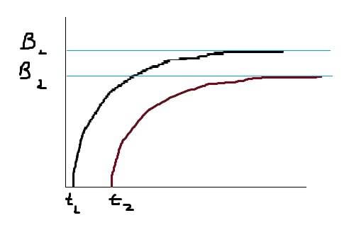

(I'm sorry for my poor English.) I draw a sketch showing the intensity of the magnetic field at two points p1 and p2, where the distance from the source (a wire carrying a current, for example) to p2 is greater than it's for p1. Is the shape of the curve correct? Is it correct that t2-t1/c is the distance traveled by the wave? Also, why is the final magnitude of B less in p2 than it's in p1 (what occurs in each point right after the wave pass)?
It is not. If t1 and t2 are distances, and the Y-axis is the intensity of the field, the curves should be start high on the left and get smaller as they go to the right.
Because the intensity of EM waves falls of as 1/r2 as the wave spreads out into space as it travels. Note that this relationship is only true for waves that are expanding as a spherical wavefront or as a portion of a spherical wavefront. If this is not happening, such as if the wave is passing through an optical system, it does not follow this relationship.
Horizontal axis represent time :biggrin:
So, is my reasoning correct?

It is not. T2-T1 gives units in seconds. In order to get a final value with units of distance you'd need to multiply by c, not divide. For example:
T2-T1 = 0.1 s
0.1s * 300,000 m/s = 30,000 s*m/s = 30,000 m. (the two units of seconds cancel out since one is on the top of the fraction and one is on the bottom)

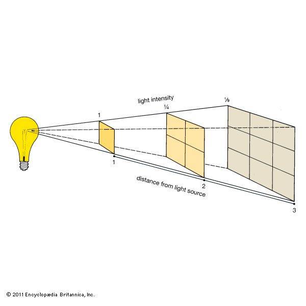

because the same amount of power ( energy ) is getting spread out over a larger and larger area
as Drakkith said ...
see this diag ... shows it very plainly ...
Dave
Likes kent davidge

In practice, unless you need to dig deep into the general behavior of waves (mandatory for any serious study of physics, optional for the interested layman) you won't bother with these mathematical gyrations. You just look at the picture davenn posted, which provides a fine explanation of how the intensity drops with the square of the distance.
