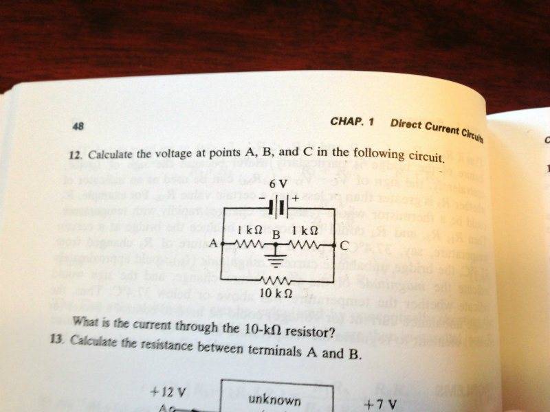

See the picture, problem 12:
Ohm's Law, V = IR, et al
So to be clear, I am being asked to calculate the voltage AT a point, not the voltage DROP across any point.
It SEEMS easy... My initial thoughts are:
A: V = 0
B: V = 0
C: V = 6
The reason: Voltage drop from one side of the battery to the other should be 6v, therefore voltage at A should be 0. All voltage should have been removed by resistance at this point.
At point C, the voltage has just left the battery, has not met any resistance, and therefore is still 6v. Pretty simple.
At point B, this is connected to the ground, therefore voltage is at 0v (am I right?)My question is:
When you connect a ground like this in the middle, could you say that there's a negative voltage drop (positive voltage gain) from point B to point A?
Moreover, will that positive voltage gain have to be equivalent to the voltage drop across the 10kΩ resistor?
Or am I thinking about this all wrong? I need to figure this part out before I can calculate current across the 10kΩ resistor...

Your answer is not correct.
Voltages are allways relative to somewhere. Try using point B (earth) at your voltage reference (eg 0V). Then look at the symetry of the circuit. There is no reason to assume that the negative terminal of the battery is also 0V with respect to earth.
You are on the right lines.
What would happen if the Earth connection was made at the positive terminal of the battery instead of point B? eg What would be the voltage at A and B if C was 0V?

Actually you don't. The ends of the 10K are connected to the battery terminals so you know the voltage across the 10K resistor is 6V.
Right, I see that now. So current across the 10k Ohm resister is 0.6mA.

You can choose to measure voltages from where ever you like as long as you are consistent and remember to specify it in the answer. In this case it would be normal to choose Earth or Point B as the reference 0V but you don't have to. Have a go using point B and let us know what you get for A and C
Suppose I used the +ve terminal of the battery as my reference point. Then...
C = 0V (w.r.t battery +ve )
B = Earth = -3V (w.r.t battery +ve)
A = -6V (w.r.t battery +ve)
After going out for dinner with the wife, a lightbulb popped on!
I think... and correct me if I'm wrong... that the voltage at C is +3v, and the voltage at A is -3v.
This would satisfy the total electric potential gain of +6v across the battery, AND 0v at ground (at point B).
Correct.
Just make sure to specify that the voltages you give as your answer are "with respect to Earth (Point B)"
