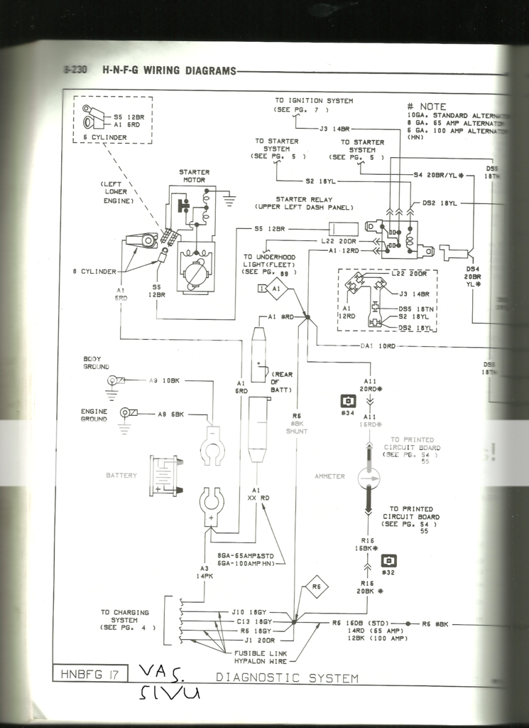

I´m Kai from Finland and me and my step dad are working to make an OBD system for 1970´s Chrysler vehicles. The company itself made one during the era and we would like to have same kind of system, only with 2010 equipment. (so no fridge- size computer for my shop)
We´ve solved most of the continuity and voltage measurements, but there are a few tacks we are fighting with.

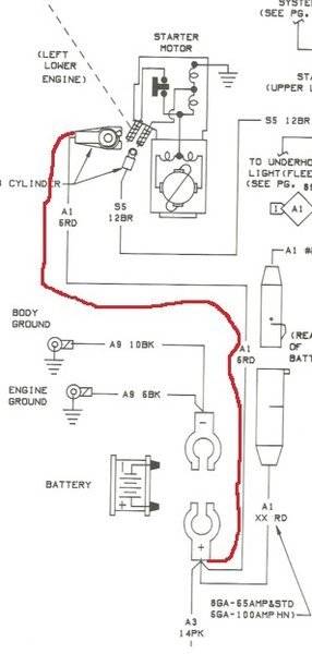

First problem is the ampere metering for starter motor: it should be able to test amperes from range 0 to 700 for cranking current evaluation and alternator output. I know there are shunts to be used in parallel with the ampere meter but they seem to have very limited ampere suppression.
Second question is that we need to get multiple information on one wire: there are only 7 wires on the OBD port for 50-60 different functions. What can be done to separate multiple analog signals from one wire? Most of the components being tested have separate grounding circuits if that helps anything. I´ve heard of multiplexing but don´t know if there´s and easier way to get into same result.
We were thinking of using a PC board in series between the OBD port and the laptop. I do the schematics and building and my step dad does the programming for the system diagnostics but neither of us is an electric engineer so I thought this might be the place for help.
Thank you for reading and hope to hear from you!

You may be right. I easily found 500 Amp 50 mV shunts online, but not 700 amps. But I did find 1000 Amp precision resistors. Because the currents are so high, safety is a big concern. A melted component carrying 700 amps is a serious hazard. Do you know the length and gauge of the wire supplying current to the starter? If so, you should be able to find the resistance of the wire and use that as the shunt. Fewer components means safer and more reliable.
In today's world, converting your analog signals to digital may be the easiest way to go about it. I think others here at PF can advise you on that.
If you stay with analog, you must guard against induced voltages by using twisted pairs or coax cables.
If you use a standard platform such as Rasberry PI, you may find many devices, boards, and mountings suitable for auto applications. I recommend that you post your questions on one of the forums dedicated to that platform. If you're lucky, you may find others who have done similar projects.
Good luck on your project. Be safe.

What you want to do is a pretty big undertaking. I am not sure you grasp the complexity of it.
This morning at your photobucket link i was able to see several pages of that Chrysler diagram but now i only get one.

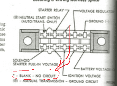

There are three unlabelled pins in your diagnostic connector , on a page i can no longer see.
Which i guess are for communication by computer.
You'll have to get that computer's communication protocol from someplace if you want to talk to the computer.
Starter current is the voltage drop along this wire
which appears to be a red #6
which is 0.3951 milli-ohms per foot at room temperature.
That'd be 0.277 volts per foot at 700 amps, a bit more at engine compartment operating temperature.
I suggest you trace out the wires in your diagnostic connector and make your own drawing of where each comes from.

I assumed the three unlabelled terminals near center were for RS232-like communication
but now that the rest of the diagrams are available it looks as if they might be not even wired !
Perhaps Kai will say for sure.
Which means he can do interface all analog , read the conditioned signals into a convenient microcontroller and program away. Good chance to learn something like an Arduino or Micromint hobbyist computer.
Or just a panel with some lights and meters.
I had hoped to learn the MOPAR OBD1 protocol for my old('95) Dodge but it looks as if his vehicles predate OBD1. So it goes.
it will be straightforward to interface those analog signals.

The photobucket images you uploaded of pgs 8-166 and 8-231 clearly show no computer connection to the diagnostic connector, there are only the six analog testpoints and Ground.

Those three blank connectors were used as a spare for future expansions as I mentioned above, such as AC and other not so important electrical circuits. However, it was dumped from the way of the OBD1.
