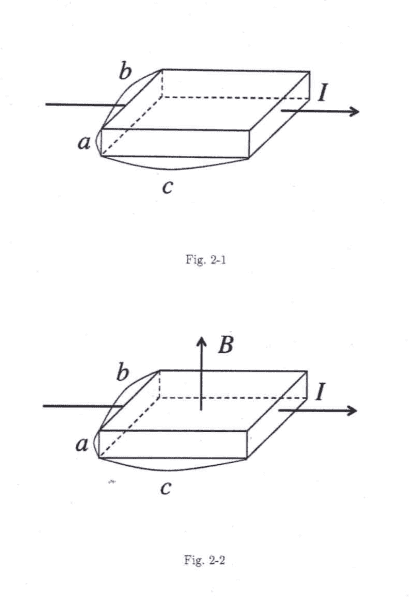

f = q.v.B.sin tetha
I = q/t = v/R
(1) q =a.b.n.v.t is it right?
(2) I = q/t = abnvt/t = abnv is it right?
(3)F = q.v.B is it right?
(4) ?
(5) ?
is it right?

nabvt gives you the number of electrons passing in a given amount of time, t. So nabv gives you the number of electrons per second. Each electron has a charge -q, so this must be multiplied to get the current (charge/time). Volts are Joules/Coulomb = Newton*meters/Coulomb, if that helps you on #4.
You can rearrange that so that Force = Volts*Coulomb / meter, then see if you can find what fits that. Once you have an expression for V, you should be able to find the last one.

4) Volts = joules/Coulomb
Volts = F/q
V=Bvq/q
V=Bv??
5) q=abnvt
I=q/t
I=abnv
n=I/abv
n=I/ab.V/B
n=IB/abV
What's wrong on this?

A force is not an energy.

V = joule (energy)/coulombs --- which is the energy?
joule can be force * distance
V = force * distance / coulombs
which is the distance?
In which direction does the force (calculated in 3) go? What is the corresponding distance where the voltage difference appears?
Using the right hand rule, in which direction is the force acting on the electrons (from F = qv x B)? Since work is the dot product of Force and the distance traveled, I think you should look for the distance in the same direction done. This is an interesting problem. I have not seen some of these terms expressed like this, but it gets you to thinking about how things are related.

4) Voltage = Joules/C = force*distance / coulombs
V = f . distance / q
V= B*v*q . b / q
V = B*v . b
distance found by right hand rule, F go trough width which is b.
5) q = abnvt
n = q/abvt I=q/t
n = I/abv V = B*v*b --> v = V/Bb
n = I / (ab)V/Bb
n = IBb/abV
n = IB/aV ---> but answer is still wrong.. which is wrong?
Right.

n = IB/aV
Right.

If you replace n by ##\frac 1 {A_H}##, it is the usual formula for the Hall effect. The Hall constant as inverse electron density takes into account that not all electrons contribute to current flow.

I meant, the key answer is n = BI/aqV... but I don't think the key answer is wrong.
Ah, n is the electrons per volume, not the charge density. Then you need the factor q in the answer (this also applies to question 2).

q in the problem statement is a charge. What you calculate here is a number.

i still don't get it. What is n stands for? And n actually what? And my answer for 1 and 2 are they right?
n is something like "5/m3" (just with a larger number for actual materials) - the density of electrons.
qn is something like "5C/m3" - a charge density.
1 is right, 2 needs an additional factor q.
