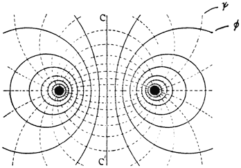

This picture is familiar, applies to all conductors and explains the dieletric/magnetic field directions and their orthogonality.
Then what do you purport to be the difference between the dielectric and the electric field?
Well, for one an electric field is thought only to exist after a charge exists and propagates with c. Second, dieletric fields must end on conductors or themselves, electric fields do not need to end on conductors, but can formed closed loops.
It mostly is semantics, they represent the same idea but the electric field is more difficult to understand because of how it ties in the electrical charge, electron. As steinmetz said, there is no more sense in thinking that current charges a space with an amount of magnetism as there is of conduction current or voltage charge a plate with a certain amount of electrification, as described above.
