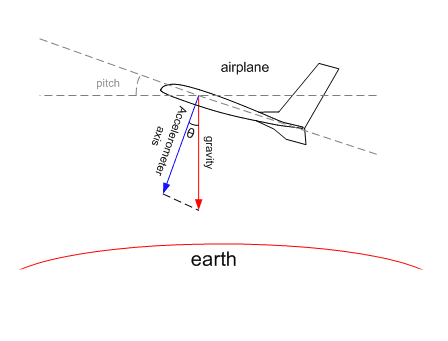

Hi,
I've received a new accelerometer with a scale factor declared in datasheet as: 800 mV/g @ 1.5g. I googled and searched the forum but still can't fully be sure I understand the accelerometer and its functioning, so please correct me where I'm wrong:
One thing that very helped me to get some understanding, was this post:
http://tom.pycke.be/mav/69/accelerometer-to-attitude
where you see this:
giving the calculation of:
accelerometer = cos (theta) * gravity
theta = acos (accelerometer / gravity)
Formula is easy and beautiful, and this is my first question please:
what 'gravity' means there? Suppose the robot owning this accelerometer is on Earth surface, then this 'gravity' means 9.8m/s^2?
Next how to relate this to my accelerometer board output please?

Yes, what they have called "gravity" would more accurately be called "acceleration due to gravity", or 1g = 9.8m/s^2.
So when you power this accelerometer and just hold it vertically, does it put out about 800mV? It is only experiencing 1g when you hold it still, so depending on what its calibration curve looks like, you might get something different (hopefully not too different). If you then turn it upside down, do you get -800mV? Or is it uni-directional?
What are its power supplies? Does it use split +/- symmetrical power supplies to give you bidirectional acceleration data? Or does it use a single supply, and have an offset in voltage for 0g?
Can you post a link to its datasheet?
The output is 0.8 volt for 1 G, so it would take (5 / 0.8), or 6.25 G, to give 5 volts out.
The A to D converter divides this 6.25 G into 1024 parts, so each is equivalent to 0.00610 G.
eg if you get a reading of 234, that is equivalent to 1.428 G. (ie 0.00610 times 234).
If you like, you can convert this 1.428 G to meters/second^2 by multiplying by 9.8
The 1.5 G figure is a measurement point only.

One word: Yech. Two more words: Double yech.
Accelerometers do not sense gravity. Period.
A 3-axis accelerometer at rest on the surface of the Earth will register an acceleration of about 1g directed up, not down. A 3-axis accelerometer at the center of mass of an orbiting spacecraft (or anywhere in an orbiting spacecraft that is not rotating with respect to inertial) will register very close to zero. Accelerometers sense acceleration due to every force but gravity. In the case of the accelerometer at rest on the surface of the Earth, the dominant force is the normal force from the ground. This normal force has a magnitude of about 1g and is directed upwards. In the case of an accelerometer in an orbiting spacecraft , the non-gravitational forces include atmospheric drag for a vehicle in low Earth orbit and radiation pressure. These are very small forces, so the accelerometer will register very close to zero.
In the case of that airplane, the non-gravitational forces are atmospheric drag, lift, and thrust. That is what the accelerometer is measuring, not gravity.

Bahhhhh. You CAN measure the gravity vector with an accelerometer. Of course, the accelerometer is a tiny mass mounted on flexures. If you rotate it around, the gravity vector change wrt to the case of the accelerometer. This is assuming that the accelerometer measurements are taken in a static condition. In other words, you CAN use an accelerometer to measure the tilt of a static device (I do that in my lab). And indeed, it is a very cheap way to do it.
Buuuut, an accelerometer will measure the sum of the forces acting on it. So as P H said, if the accelerometer is free falling it will sense 0. If it is accelerating then it will measure some other thing of course.
waduppp physics?! I am an engineer so forget all the theo talk about Einstein etc. Good for a coffee talk, but let's be practical here please.
javiramos2008 said:
Bahhhhh. You CAN measure the gravity vector with an accelerometer. ... This is assuming that the accelerometer measurements are taken in a static condition.
You are not measuring gravity here. Think of it this way: An accelerometer that is sitting still on the top of a table will register an acceleration of about 1g directed upward.. The acceleration due to gravitation points downward, not upward. What you are measuring is the acceleration due to all of the forces acting on the accelerometer except for gravity. It is the table (contact force) and the atmosphere (buoyancy) that are pushing the accelerometer upward -- and that is what the accelerometer is sensing.
This sensed upward acceleration can be used as a proxy for gravitation with the assumption that the object is stationary with respect to the rotating Earth -- but you are not measuring gravity. Attach that accelerometer to an apple and let the apple fall and the accelerometer will read zero.
This distinction might not be so important for things that are essentially stationary with respect to the rotating Earth. Simply make the stationarity assumption, filter out high-frequency changes to address minor violations of that assumption, and voila! you have a proxy for gravity. The distinction is extremely important for inertial navigation systems on aircraft and spacecraft . The navigation software needs to augment the sensed accelerations with a computed gravitational acceleration to get anywhere close to an accurate representation of the vehicle's state over time because gravitation itself is unmeasurable.
Even with the stationarity assumption, the sensed acceleration is not yet a proxy for gravitation. The stationarity assumption pertains to the rotating Earth, so you are implicitly dealing with a rotating frame of reference here. You have a proxy for gravity, not gravitation (see [post=1602624]this post[/post]). The distinction in physical geodesy between gravity and gravitation is small given our small rotation rate of 1 rotation per sidereal day. The distinction would be much greater if a day was only 90 minutes long.
@javiramos
You can't win here - I have made all these objections already and they are 'reasonable' but rejected. I have become reconciled with what the purists are saying but I agree with you that you CAN measure g with an accelerometer AND a stationary mounting. You need to be able verify that the mounting (table top) is not accelerating, though. It could be slowly sinking into the ground or rising and then you'd get the wrong answer. AS an Engineer, at heart, I'd go for that measurement, though.
Two comments:
1. You are not measuring g. You are measuring a proxy for g based on the assumption that the object is not accelerating with respect to the rotating Earth. Slap that accelerometer on an apple up in a tree. The accelerometer will measure approximately 1g upwards (not downwards) up until the moment the apple breaks loose from the tree. It will then register zero. This drastic change in the measured value doesn't mean gravity has changed. The gravitational force on the apple hasn't changed one iota.
2. Even when the proxy measurement is valid (i.e., the object is indeed stationary with respect to the rotating Earth), you still are not measuring the gravitational acceleration. The proxy measurement is the vector sum of the gravitational acceleration plus centrifugal acceleration. That centrifugal acceleration is small (about 1 part per 500 at the equator), but it is there. Even a lousy off-the-shelf MIMS accelerometer has much better than 3 digit accuracy.
D H said:
Two comments:
That's precisely what I said: "you CAN measure g with an accelerometer AND a stationary mounting"
If you like, you can do the measurement at one of the Poles or, using some extra information about radius and rotation, then you can calculate g.
What amazes me is how this is, somehow, regarded as 'special' as measurements go. If you want to measure almost any physical quantity you need to make multiple measurements of a number of different quantities. All that stuff about falling apples is totally obvious and, in the same way as you'd do an electrical measurement or an energy measurement, you would use extra information to get your answer.
