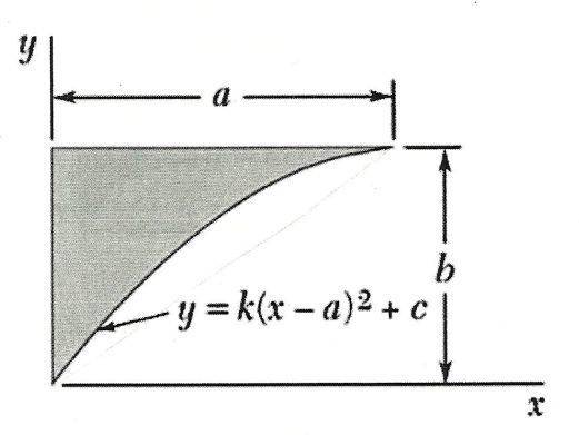

Find the moment of inertia, Iy, about the y-axis using a vertical strip, width dx.
Use the given equation and eliminate constants k and c, express answer in terms of number and powers of a and b.
I can't figure out how to eliminate the constants k and c?
Pick out two points on the curve where you know the coordinates. Use these values to obtain two equations in two unknowns (c and k).

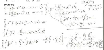

Ok. So far this is what I have:
I know the point at the origin (0,0). And x=a and y=b.
0 = k(0 - a)2 + c = ka2 + c ==> k = -[itex]\frac{c}{a^2}[/itex]
So,
y=(-[itex]\frac{c}{a^2}[/itex])(x-a)2 + c
I'm still not sure how to get rid of the c?
I see... so x=a, y=b
b=(-[itex]\frac{c}{a^2}[/itex])(a-a)2 + c
b=(-[itex]\frac{c}{a^2}[/itex])(0)2 + c
b=c
...I think??

I've attached a scan of my work. Now that I've looked at the problem, I think I left out a "b-" for my "ydx". I think that it should be (b-y)dx. Seem right?
Yup. b-y(x) is the length of the differential strips.

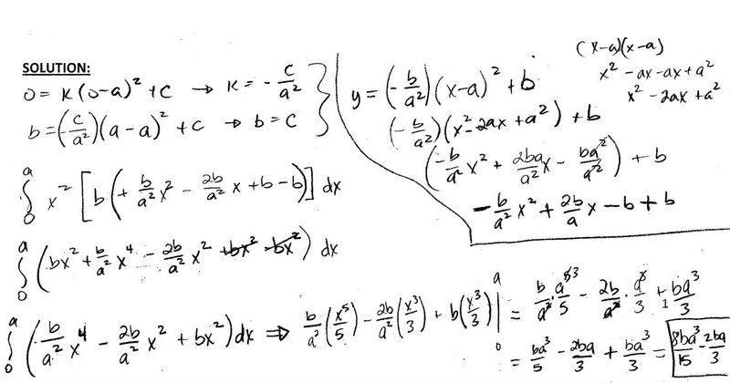

After including "b-" in my problem my answer came out to be:
[itex]\frac{8ba^3}{15}[/itex] - [itex]\frac{2ba}{3}[/itex],
without factoring.
Radius of Gyration: Ky = [itex]\sqrt{\frac{(\frac{8ba^3}{15} - \frac{2ba}{3})}{(b-y)dx}}[/itex]
Your integral should look something like:
$$\int_0^a x^2\left[ b - \left[-\frac{b}{a^2}*(x - a)^2 +b\right]\right]dx$$
$$= \int_0^a x^2\left[\frac{b}{a^2}(x - a)^2\right]dx$$
$$= \int_0^a b x^2 - 2\frac{b}{a}x^3 + \frac{b}{a^2}x^4 \, dx$$
Evaluating the last form term by term should leave you with terms having b to the power of one, a to the power of three only. Try the integral again.

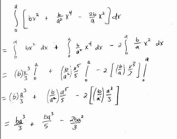

I see what I did wrong. Instead of having (-[itex]\frac{2b}{a}[/itex]x3), I had: (-[itex]\frac{2b}{a^2}[/itex]x3).
I now have: ba2*([itex]\frac{8ba}{15}[/itex] - [itex]\frac{2}{3}[/itex])??
I believe I integrated correctly.
If that's your result for the integration, it's not correct. Integrate term by term and show your work.

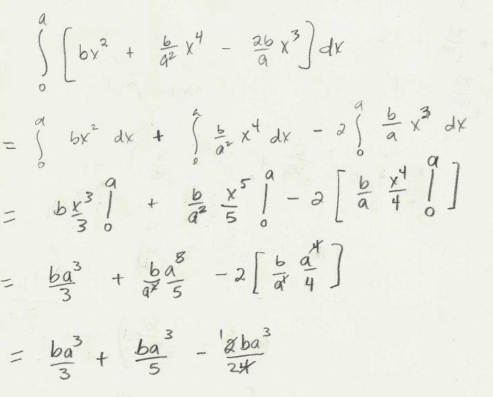

Here is the new integration that I did. I didn't know if I should leave it as is or try to simplify it. There are no instructions that say to do so.
In the first line of your attachment, the term with the coefficient -2b/a should be an x3 term, not x2. There's one x2 term, one x3 term, and one x4 term going into the integration.
Dang...I see! After I distributed the x2 I didn't apply it to that part.
Alright...
After re-distributing the x2 into my (b-y)dx, I got the answer that is in the image attached.
I guess I could factor out the ba3 and add/subtract fractions...
