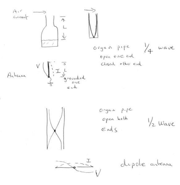

Don't forget that the EM wave in the air is a traveling wave.
This induces a standing wave in the antenna. So one part of the antenna is always at zero and another part is always at a maximum.
This is what I meant by the 'organ pipe' model.
Have you seen this? - It is the simplest model I know of antenna action.

Here is a very quick rundown before I knock off.
If you blow across the top of a partly filled bottle you can generate a resonant sound or tone within the bottle. The tone or frequency depends upon the length from the water surface (don't waste beer on this) to the mouth as shown.
This is equivalent to an organ pipe, closed at one end as shown with a standing wave inside.
The air at the closed end cannot move freely so forms a permanent node.
If we place a conductor rod or wire in an EM field and ground one end we find the same effect in the conductor.
The EM field has a voltage between points in the field. These induce a voltage in the conductor between the ends. Since one end is grounded its voltage cannot change, but the other end chages in sympathy with the field changes.
The current waveform is of the opposite phase, shown dashed.
If we have an organ pipe open at both ends or ground our rod in the middle, both ends are free to vary as shown. This is called a half wavelength dipole as an antenna.
