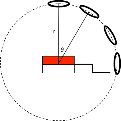

The formula you used for the induced voltage in your previous experiment is only an approximation of the actual result. It was obtained on the assumption that the B field due to the permanent magnet is uniform over the surface of the pick-up coil (I prefer that name to solenoid) and points in the ##+z##-direction, perpendicular to the plane of the coil. This assumption works for ##z >>R## where ##R## is the coil radius. If you move the coil away from the ##z##-axis, I suggest that you not move it parallel to itself because the dependence of the B-field on the radial direction becomes unnecessarily complicated. Instead, consider turning the coil as you move it so that its plane is always perpendicular to the radius ##r## from the center of the magnet to the center of the coil. Then plot the induced rms voltage as a function of spherical angle ##\theta## from the ##z##-axis. The coil must be in the ##xz## plane. In that case, the dipolar approximation for the magnetic field that you have already used predicts that the voltage as a function of angle at fixed radius ##r## varies according to ##V(\theta)=V(0)\cos\theta##, where ##V(0)## is the rms voltage at zero angle that you have already investigated.

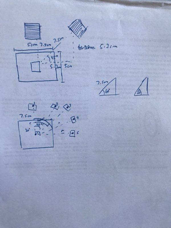

I was just wondering when you explaining you're above statement would you mean something like this
where say for the top example if the magnet housing was 5 x 5cm (From memory I think it is) and I wanted to measure at a distance r = 7.5cm, I would move the magnet around keeping it perpendicular with the dipole moment of the magnet and keeping it a distance of 7.5cm, so that for an angle of 45 from the x (also then 45 from the z) it would be 7.5sin45 and 7.5cos45 on the x and y coordinates respectively. And then say for the second sketch at the bottom it would be some combination like that, where the angle in your formula you've given corresponds to that angle 30, 45, 60 and 90 from the z (Where the expected value for 90 would be zero, but because the field is not uniform it will be slightly higher experimentally)?

Here is what I had in mind.
The dipole moment rotates in the yz-plane and the sampling circle is in the xz-plane, also the plane of the screen. Within this model, when ##\theta=90^o## the flux through the coil is zero. If you are told that you cannot do it this way, argue that this setup makes sense. The magnetic field depends only on ##r## and ##\theta## and is symmetric about the ##z##-axis. You have already established the dependence on distance when ##r=z##; it makes sense to investigated the angular dependence by changing only the angle and keeping ##r## constant. Furthermore by turning the coil as shown in the figure, you maximize the magnetic flux through it. Moving the coil along the x-axis changes both ##r## and ##\theta## at the same time which makes it harder to sort out which change is responsible for changing the voltage. The idea behind experimental design is to keep it simple, simple to perform and simple to analyze.
