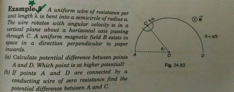

This is not a homework.i am not able to understand rotating motional emf .so could u please tell why could we use the effective length to calculate emf in this case .
Textbook page showing Example 5 text on a wire bent into a semicircle of radius a, rotating about horizontal axis through C, with magnetic field B into the page, and Fig. 24.83 diagram showing semicircle with points A, O, D and C marked, angle theta measured at O, and omega shown.

Maybe that is an easier approach, but not the only one. It can also be solved using the straightforward calculus method. Is the answer given?
Please can anyone help me to prove that in this case the shape doesn't matter and hence effective length can be used to calculate motional emf

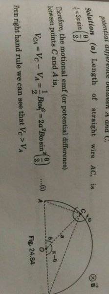

Thank you so much for your reply ,yes the answer is given, actually had a doubt that why can we use the effective length though the velocity of every point is different.i mean i am not able to prove that the shape doesn't matter ...so could u please help me prove it in this case ,i am able to prove it when there is no rotation. This is from DC PANDEY
I have attached the solution if it helps
  • Solved example from a physics textbook: a semicircular wire AC rotating about point O in a magnetic field B marked into the page, with radius a, angle theta and a dashed chord, followed by the induced emf working V_C - V_A = (1/2) B omega l^2 = 2 a^2 B omega sin^2(theta/2).

This effective length part can be proved using some calculus. Do you know how to set up a differential equation?

Consider the section OCA only. Here, you want to show that arc-length AC is effectively equal to the straight line distance AC. What is the emf induced in the straight line AC if length AC=l?
It's half(B)(w)L²
