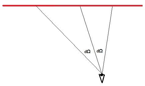

  • #286
Charles Link said:
The answer is yes, it will look equally bright everywhere. You might find it of interest that you also wouldn't be able to tell whether it is flat in shape or concave inward or outward.
Yes, this is what I indeed expected. So if distance doesn't matter regarding the received energy in a fixed solid angle, can I also say the following:
If the two ##d\Omega##'s in the picture are equal in size, the power received from each solid angle would be the same?
  • #287
This would need the emission to be taking place at the surface. Observing the Sun, you see it is a bit dark at the edges so the flux per solid angle is not actually the same in that (practical) case. (Danger - do no observe it directly!)
  • #288
Yes, you have it correct. One thing to note that the irradiance ## E=L \, d \Omega ## is the same for both. The power received per unit area by a flat detector could differ by a ## cos(\theta) ## factor because the irradiance ## E ## is measured in a plane normal to the direction of the small solid angle increment ## d \Omega ##.
  • #289
If you say a flat detector could receive less ##E## from the left sided ##d\Omega## (in the picture) by a factor of ##cos(\theta)## since ##E## is measured in the normal plane of ##d\Omega##, doesn't this imply that if I don't look at the edges but straight normal to the flat source, I'd notice dark edges from the sides of my viewing angle because my (more or less) flat retinas are not in the normal plane of the left sided ##d\Omega##. And when I move my eyes to the edges so that my retinas are normal to the left sided ##d\Omega##, I'd be receiving the same ##E## from that ##d\Omega## as the normal ##d\Omega## that I was looking at previously?

  • #290
Very good. You have it correct. The eye is slightly more complicated having a lens, and the precise details of the brightness of the image at points far off-axis is beyond the scope of what we need here. In any case, if you look in the direction that is off-axis, you see the same ## E ## as you stated in the last sentence.

Charles Link said:
B in some ways thinks he is seeing the projected area, but he is actually seeing the surface which is farther away and with an increased area. He really can't tell the difference between the two if there is nothing of contrast to focus on.
Ah ok, but if one wants to calculate B's radiance using his solid angle ##d\Omega_B## he should use $$d\Omega_B = \frac{A_{projected}}{(\frac{s_A}{cos(\theta)})^2}$$
Where ##s_A## is the distance of A to his own surface, right?
  • #300
The angle ## \theta ## here doesn't stay constant throughout the calculation. ## s_A ## is the perpendicular distance to the second surface, but since you have an extended angle of viewing, ## \theta ## will not be constant. Also, ## A_{projected} ##, if you are using this formula, which has an increased distance ## s=s_A/cos(\theta) ##, needs to come from the location of that point on the surface. (The ## A_{projected} ## will be larger if you measure it at a location which is farther away, as is necessary to keep the ratio ## \Omega=\frac{A_{projected}}{s^2} ## constant for constant ## \Omega ##).
