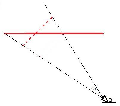

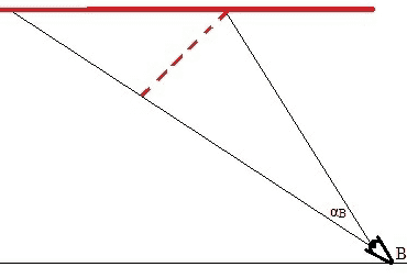

  • #301
Charles Link said:
Also, AprojectedAprojected A_{projected} , if you are using this formula, which has an increased distance s=sA/cos(θ)s=sA/cos(θ) s=s_A/cos(\theta) , needs to come from the location of that point on the surface. (The AprojectedAprojected A_{projected} will be larger if you measure it at a location which is farther away, as is necessary to keep the ratio Ω=Aprojecteds2Ω=Aprojecteds2 \Omega=\frac{A_{projected}}{s^2} constant for constant ΩΩ \Omega ).
This is exactly what I was wondering since ##dA_{projected}## indeed changes depending on where you draw it. So from the 2 pictures here:
The picture on the right is the correct one if you're using the increased distance ##s = s_A / cos (\theta)##?
  • #302
View attachment 207845 View attachment 207846
I think you have the basic idea. The ## dA_{projected} ## can be measured anywhere, just so long as the ## s ## that is used is the distance at which ## dA_{projected } ## is measured, in order to properly determine ## d \Omega=d A_{projected}/s^2 ##.

  • #304
JohnnyGui said:
That's indeed what I thought. But I have a feeling that this is merely done just for the sake to keep ##d\Omega## constant. Which ##dA_{projected}## does ##B## truly observe when the radiating surface covered by B's viewing angle is the only surface that is radiating?
Your eye is not an accurate measure of brightness regardless because (if I have this part of the anatomy correct), it contains an adjustable iris, so that when we are in bright light, we only use a part of the lens of our eye. Cameras also have this same feature, which is the f-stop #. In any case, a given area on the retina maps into a given solid angle, and if the area of the lens stays constant, then what we see is a good measure of the surface brightness. ## \\ ## Editing... To answer your question of where doe the radiating surface originate? , it really doesn't matter. When we see a solid angle of our field of vision illuminated with a certain brightness, the actual location of the surface (i.e. the distance that the surface is from us), is irrelevant. ## \\ ## Additional editing.. An important part of a previous discussion was the action of the lens of your eye. If you could crawl inside a person's eye and get a view of the retina, you would see the scene the person is looking at: It would appear like a photograph does across the surface of the retina. The focused scene is projected by the lens onto the surface of the retina like it were a projection screen. If there is a surface of brightness ## L ## (e.g. bright orange) in the field of view, it would show up in the scene on the retina basically as an orange spot (shaped like the surface) with a brightness proportional to ## L ##. (If you can control and/or account for the iris mentioned in the first sentence above, the eye would actually be a good measure of surface brightness.)
  • #305
@JohnnyGui I edited the last post, so be sure and read the updated version.
  • #306
Ah, I forgot about the fact that anything that fully covers the solid angle of our field of vision would seem to have the same size, regardless of distance (sort of like the moon and the sun).
Charles Link said:
Additional editing.. An important part of a previous discussion was the action of the lens of your eye. If you could crawl inside a person's eye and get a view of the retina, you would see the scene the person is looking at: It would appear like a photograph does across the surface of the retina. The focused scene is projected by the lens onto the surface of the retina like it were a projection screen. If there is a surface of brightness LL L (e.g. bright orange) in the field of view, it would show up in the scene on the retina basically as an orange spot (shaped like the surface) with a brightness proportional to LL L . (If you can control and/or account for the iris mentioned in the first sentence above, the eye would actually be a good measure of surface brightness.)
Regarding the projection of the radiating surface on the retina, can I say the following explanation about brightness?:
Watching a radiating surface from an angle would indeed make an observer receive less power, i.e. less photons, but the projected surface area on the retina is also smaller because of the angle. So the lesser amount of photons are concentrated in a smaller retina surface so that photon density stays the same.
If this causes the equal brightness, then this must mean that the optical nerve doesn't measure brightness by the absolute number of light receptors that are stimulated but by the photon density per unit retina surface.

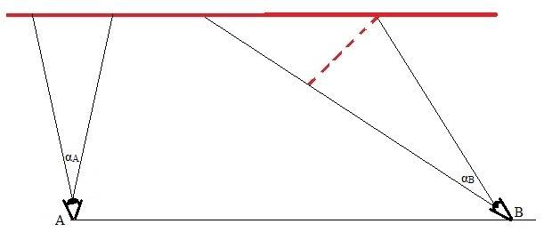

Charles Link said:
The retina is in the focal plane of the lens of the eye when the eye is focused on a distant scene. Each location on the retina corresponds to a given angle in the far-field. If the scene in the far-field is uniformly illuminated (like a blue sky), the retina will receive an approximately uniform image. It won't be a perfect mapping, but we normally can not discern any lack of uniformity that might result.
Ah, so if I understand correctly, for the following 2 scenarios, in which ##\alpha_A=\alpha_B##,
The projected surface size on the retina is in both cases the same (if it's not too far off-axis)?
  • #311
The size on the retina will be ## \Delta x=f \alpha ## where ## f ## is the focal length of the lens of the eye, and ## \alpha ## is the angle measured in radians. ## \\ ## To supply some extra detail on how this is computed, parallel rays incident at some angle come to a focus in the focal plane, and the ray that is incident on the center of the lens, (even it comes in at angle ## \theta ##), passes through as a straight line to the focal plane, while the other rays incident at angle ## \theta ## at other locations on the lens will be focused by the lens and meet the central ray in the focal plane. The position of these incident parallel rays that come to a focus in the focal plane is thereby given by ## x=f \theta ##, for small angles ## \theta ##.
  • #312
Got it, and this calculated ##x## would be the same for both ##A## and ##B##?
And it needs to be not too far-off axis because otherwise the same ##\alpha## would cover a too large surface for which an integration would be needed to calculate the projected surface area instead of just a ##cos (\theta)## factor?

  • #315
JohnnyGui said:
Got it.
Sorry if I'm blacking out again but is it correct that, even though the projected retina image is the same for ##B## and ##A##, the total energy that ##B## receives on his retina is less than ##A##'s received energy because the distance from ##B##'s lens to his radiating source part (that ##B## is looking at) is larger than the distance from ## A##' s lens to the radiating surface part that ## A ## is looking at? (## B ##'s radiating surface is larger by a factor of ## \frac{1}{cos(\theta)} ## but that is already compensated by Lambert 's cosine law, so there's a net less energy for ##B## by a factor of ## cos(\theta)^2##)
Almost, but no cigar. B's radiating surface is larger by ## \frac{1}{cos^2(\theta)} ## precisely accounting for the inverse square extra distance. There is no accounting for the first ## cos(\theta) ## factor though, which is the projected area of the lens. For small angles ## cos(\theta) \approx 1-\frac{\theta^2}{2} \approx 1 ## so that we like to work with small angles ## \theta ##. Otherwise, it gets overly complicated mathematically, and really offers little additional instructional value.
