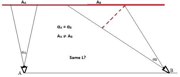

From my previous post I noticed, as we discussed, that the ##cos(\theta)^4## both in the numerator and the denominator cancel each other out so that looking at the same ##A## from any angle would give the same Radiance ##L##.
This made me realize something about 2 different scenarios;:
Left picture
If the radiating surface area is fixed and 2 observers are looking at that fixed radiating surface area, then ##B##'s field of view ##\alpha_B## is smaller than ##\alpha_A## (let's say because B has a smaller iris/aperture). Nevertheless, they should still measure the same Radiance ##L##?
Right picture
And when the field of view angles are the same for both ##A## and ##B## (##\alpha_A = \alpha_B##), such that each observer would cover a different radiating surface (##A_B > A_A##) then the measured ##L## would still be the same for both observers.
Are these 2 statements correct?

The answer is precisely the same brightness ## L ##, provided the surface is a Lambertian radiator. An ideal blackbody surface is a Lambertian radiator. ## \\ ## There are many sources that have some directional dependence so that when viewed from a different angle you get totally different results. A good example of this is a flashlight, where if you are in the center of the beam the whole reflector is illuminated, but outside the central beam, all you see is a lit filament without any contribution from the reflector. In this case the reflector has a different brightness when viewed from an angle.

Thanks, I tried it and I was indeed able to calculate and prove the same ##L## for A and B in all scenarios and that a Lambertian radiator is needed to measure the same ##L##. :)

...only gives the same ##L## for ##B## and ##A## if B is perpendicular to the radiation direction?
If only one observer is looking at a large radiating surface, then that one observer would have rays coming from ##dA##'s of that large surface that are not perpendicular to that observer. Since, according to the picture above, the observer ##B## needs to look perpendicularly at the same ##dA## to have the same ##L## as ##A##, this means that for the one observer looking at a large surface, each ##dA## of it would give him a different ##L## since he's not perpendicular to each one of them.
The brightness ## L ## is independent of how you observe it. The formula ## E=L \, d \Omega ## only holds if the receiver is aimed at the surface. If you keep the receiver fixed in position at angle ## \theta ## but turn it horizontal with the same receiver area ## dA_r ##, you get a power incident on that surface ## P=L \, d \Omega \, dA_r \, cos(\theta) ## and the irradiance onto the receiver surface is ## E=L \, d \Omega \, cos(\theta) ##.
  • #359
My bad, I think I got it. Let me write ##P## and ##d \Omega## all out for the following scenario:
Here, ##dA_1 = dA_2## so that the field of view must be ##\alpha_1 > \alpha_2##. The receiver ##dA_R## is only perpendicular to ##dA_1##, not to ##dA_2##.
To calculate ##L_1## for ##dA_1## by writing the formula for ##P## and ##d \Omega## all out, I'd have:
$$L_1=(\frac{\sigma T^4 \cdot dA_1}{\pi} \cdot \frac{dA_R}{R^2}) \cdot \frac{R^2}{dA_1} \cdot \frac{1}{dA_R} = \frac{I_0}{dA_1}$$
To calculate ##L_2## for ##dA_2##, in which the ##P## contains a ##cos(\theta)^4## in the numerator for increased distance, projection of ##dA_R## and Lambert's cosine law. And in which the ##d \Omega## contains a ##cos(\theta)^2## for the increased steradian area and a ##cos(\theta)## for the projection of ##dA_2##, both in the denominator, along with an extra ##cos(\theta)## since you're dividing by the projection of ##dA_R##. This gives:
$$L_2=(\frac{\sigma T^4 \cdot dA_2}{\pi} \cdot \frac{dA_R \cdot cos(\theta)^4}{R^2}) \cdot \frac{R^2}{dA_2 \cdot cos(\theta)^3} \cdot \frac{1}{dA_R \cdot cos(\theta)} = \frac{I_0}{dA_2}$$
So both ##dA_1## and ##dA_2## have the same ##L## since they have an equal surface area as said earlier.
Sorry for missing this, I keep on forgetting certain ##cos(\theta)## factors every time I write this down in my head.

Very good. I have one minor correction/suggestion. In your equations for ## L_1 ## and ## L_2 ##, your final result can be simplified. If you simply do the algebra, you get ## L_1=\frac{\sigma T^4}{\pi} ##, and likewise ## L_2=\frac{\sigma T^4}{\pi} ##. (This is a very well-known result for a blackbody). In any case, very good. :) :)
