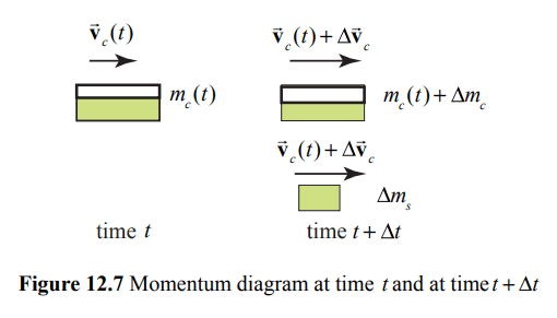

Please study this diagram. It is the system at times ##t## and ##t +Δt##. In this arbitrary slice of time there is one piece at ##t## and two pieces at ##t +Δt##. Nothing is being redefined. Note ##Δm_c = -Δm_s##.
Starting with the variables in the diagram of post ##10## we can write the system momentum at times ##t## and ##t + Δt##;
$$\vec P(t ) = (m_c + m_s -bt)\vec v_c(t)$$ and
$$\vec P(t + Δt) = (m_c + m_s - b(t +Δt))(\vec v_c(t) + Δ\vec v_c) + Δm_s(v_c(t) + Δ\vec v_c)$$
Then we can write ##\vec F = \large \frac{Δ\vec P}{Δt} = \large \frac{\vec P(t + Δt) - \vec P(t )}{Δt}##
Now compare that to what MIT used ;
$$\vec P_{sys} (t) = m_c(t) \vec v_c (t)$$ .
$$\vec P_{sys} (t + Δt) = (Δm_s + m (t) + Δm_c)(\vec v_c(t) + Δ \vec v_c )$$
where ##Δm_c = −Δm_s## , ##m_c (t + Δt) = m_c (t) + Δm_c## and ##m_c(t) =m_c + m_s − bt##
substituting their notation and rearranging my equations a bit we get;
$$\vec P(t ) = (m_c + m_s -bt)\vec v_c(t)~~ →~~\vec P_{sys}(t ) = m_c(t)\vec v_c(t)$$ and
which becomes
$$\vec P_{sys}(t + Δt) = (m_c(t) - bΔt))(\vec v_c(t) + Δ\vec v_c) + Δm_s(v_c(t) + Δ\vec v_c)$$
or
$$\vec P_{sys}(t + Δt) = (Δm_s +m_c(t) +Δm_c))(\vec v_c(t) + Δ\vec v_c)$$
since ##-bΔt = -Δm_s = Δm_c##
They are the same and they mean the same.

Although the definitions of ##m_c## etc. need a little translation, I agree that your equations match those at the link. And they share the sin of not defining what the 'system' is.
You later supplied a definition, but it doesn't match the equations. If you define p(t) as the momentum of the cart and remaining sand at time t then it is just a matter of algebra that $$\vec P(t + Δt) = (m_c + m_s - b(t +Δt))(\vec v_c(t) + Δ\vec v_c)$$
To get your equation and the one at the link, you have to define P(t) in a very awkward way; so awkward I have failed to find a form of words to describe it.
The whole matter can be resolved by accepting that ##\vec P(t + Δt)## is as I have written it above and then observing that the change in the momentum of this system is due not only to the applied force F but also because we are no longer including a bit of momentum that has gone off with the lost sand:
$$\vec P(t + Δt)-\vec P(t) = (m_c + m_s - b(t +Δt))(\vec v_c(t) + Δ\vec v_c)- (m_c + m_s -bt)\vec v_c(t)+\vec F.Δt+bΔt\vec v_c(t)$$
Edit: should be
$$\vec F.Δt-bΔt\vec v_c(t)=\vec P(t + Δt)-\vec P(t) = (m_c + m_s - b(t +Δt))(\vec v_c(t) + Δ\vec v_c)- (m_c + m_s -bt)\vec v_c(t)$$

Fine. Pick some time between 0 and ##\frac{m_s}{b}##, call it ##t'##. Then call the first equation ##p_1## and the second equation at a ##Δt## later ##p_2##.
  • #52
bob012345 said:
The problem at hand consists only of everything at time t and everything at time t+Δt. I kept track of that interval only not all Δt′s.
I disagree. Tell me again the definition of your system at any time t
  • #53
At time ##t## the system is the left hand side of this figure. It consists of the mass of cart plus however much sand is in the cart at that moment traveling with velocity ##v_c##. Here it is in all it's glory;
  • #54
So your working becomes
Let p(t) be the momentum of the system consisting of the cart and its remaining sand at time t:
##\vec P(t ) = (m_c + m_s -bt)\vec v_c(t)##
Thus ##\vec P(t + Δt) = (m_c + m_s - b(t +Δt))(\vec v_c(t) + Δ\vec v_c))##.
But the momentum that had been in ##\vec P(t )## is now shared between ##\vec P(t + Δt) ## and the sand that was lost in interval ##(t, t + Δt) ##. That lost momentum is ##-Δm_s(v_c(t) + Δ\vec v_c)##. (##Δm_s## being negative).
[We can simplify to ##Δm_sv_c(t)## since the other part is a second order small quantity.]
Were there no external force, conservation of momentum gives
##\vec P(t ) = \vec P(t + Δt)- Δm_s(v_c(t) + Δ\vec v_c)##, or ##\Delta \vec P(t ) = Δm_sv_c(t) ##.
But in the same interval, a further ##\vec F.\Delta t## has been injected into the system, so
##\Delta \vec P(t ) = Δm_sv_c(t) +\vec F.\Delta t##.
Looks ok to me.
Looks ok to me.
I like the conserve momentum approach except for or up to ##\vec FΔt##.
