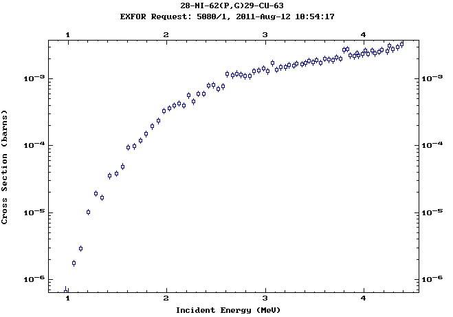

Dan Tibbets
I have argued with others on the Talk Polywell forum about the Nuclear Binding Energy per Nucleon vs the Total Nuclear Binding Energy per Nucleus graphs (which is the NBE/Nucleon * the atomic mass number). Despite referenced statements that, while the total binding energy increases continuously with larger nuclei, it is the binding energy / nucleon (which peaks at 62Ni) that determines the energy balance.
I have argued that the first graph is the appropiate tool for predicting the exothermic or endothermic nature of a reaction, and have given multiple references like this one-

It does appear to me that this reaction would be slightly exothermic. Practical realization is a separate issue.
For your example, the mass of copper 63 is:
62.9295975
the mass of Nickel 62 is:
61.9283451
and the mass of a proton is:
1.007276466812
Thus the reaction releases a small amount of energy: the energy equivalent of .006 amu.
The obstacle to this happening in a cold environment is not that it is endothermic, but that the proton can't get close enough unless it is moving fast - high temperature. Deuteron-Deuteron fusion is certainly exothermic, but that doesn't mean it happens via cold fusion.

Copper 63 is stable, period. There is nothing it can decay to with release of energy.
I know all about binding energy per nucleon, mass per nucleon, etc. All of that is irrelevant to the energy balance of a particular reaction in the abstract (e.g. where you can posit a beam of protons of the right energy hitting a target). Binding energy per nucleon says a lot about what processes will occur with any measurable rate in a plasma or stellar interior - but this is separate from whether a particular reaction is exothermic or endothermic.
Your aim was to argue that proton + nickel 62 -> copper 63 is requires net input of energy. This is simply false. Copper 63 is a lower energy state than nickel 62 *plus a proton*. If a proton has enough energy to reach the Nickel nucleus, the reaction will proceed with release of energy (gamma plus KE Copper 63 will be greater than KE total for proton and Nickel 62).
You might get more responses if you clarify, very briefly, your question (if you have a question) or the point you wish to discuss. Not many people are going to wade through all the prose, and I confess you lost me several posts ago.
One way to see that the statement that "Ni-62 + proton -> Cu-63 is exothermic" is not inconsistent with the statement that you would essentially never see this as a fusion reaction (while you certainly could if you shot a proton beam at a nickel target) is the following observation:
In any environment with lots of Ni-62 and protons at high temperature and density, the reaction chain of 4 protons to He-4 is energetically favored by a factor of 4, and does not have a huge coulomb barrier. Thus in any fusion favoring environment, the Nickel reaction would be insignificant, probably undetectable.

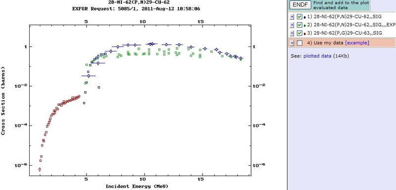

Isn't the key here that it would take MORE energy to cause the Hydrogen to fuse with the Nickel than the reaction itself actually releases? Trying to shove a proton towards 28 other protons is going to take a good amount of energy. I think it is obvious that all reactions where a proton fuses with a nucleus releases energy if you only look at the different masses, but the process of getting it to fuse is where all that energy goes.
So while a Proton + Nickel fusion would release energy, it would not release more energy than it takes to cause the fusion in the first place.
Or perhaps I am mistaken?
All fusion involves overcoming coulomb repulsion. That's why high temperature / density are required. It's a matter of degree - for Nickel you have enormously higher barrier than for light elements. However, if you have a proton with enough energy to get close to the nickel nucleus, it can react to produce copper, and the reaction products will return all of the proton's kinetic energy plus more. That's all it means to say the reaction is exothermic.
Now, to ask if it is a plausible source of energy, you need many other conditions, which will defeat this reaction for practical use. First, the temperature needed would be absurd, even compared to other fusion reactions. Second, as I mentioned in an earlier post, this reaction would compete with other reactions that are so favored energetically and with lower barrier, that, for practical purposes this reaction wouldn't occur (but not because it is endothermic - that is simply false).
Note that if you continue hitting a target with protons off appropriate energy, you will reach a point where after absorbing a proton, fission will occur. But this is way beyond copper.

Yes, of course. The thread got side tracked by two things:
1) OP focus on binding energy per nucleon, which is not directly relevant to the energy balance of a particular reaction.
2) My focusing on whether the reaction would be energetically favored to occur once the proton was close to the nucleus, e.g. whether a proton beam would produce this reaction. I forgot to consider how inelastic this process was, and that it was possible for very little of the initial proton KE to be returned.
So, yes, the real question comes back to the coulomb barrier and related issues.
1) The coulomb barrier should make the crank process impossible on its face.
2) If you had a plasma of Ni-62 and protons of sufficient temperature for protons to be absorbed, then:
a) independent of energy balance, the reaction would be very rare because proton->...>He-4 fusion would enormously favored, energetically and by cross section (largely due to enormously lower coulomb barrier).
b) If a few such reactions occurred, then they might actually cool
