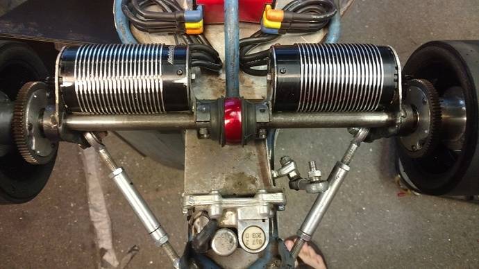

metastable said:
First I will share an example of the equations I would use to calculate the power consumption of a given standard land vehicle at a given speed in a given set of conditions.
sysprog said:
The ACME Corporation cannot guarantee the safety of a rider aboard an electric skateboard operated at a speed exceeding 100 mph100 mph100\ mph.
for comparison I will share a photo of, what I personally consider, a "standard car"-- quite literally the drivetrain of the fastest electric skateboard in the world, capable of 70+ ##mph##:
  • #147
Please sign your organ donor card before riding that thing, kid; how do you deal with the snap (aka jounce)? Oh, and, I have a friend whose pet kitty needs a cornea transplant. On a slightly more technical note, umm -- WB cartoon speed was measured in frames per second (12 fps doubled to 24); not really mph -- Mr. Coyote's speed is forever less than that of the Road Runner, speed in this instance being considered as the derivative of distance with respect to time -- the reasoning behind the standard for the time required to complete 1 frame (not for the artist; for the viewer) is hinted at by the following inequality constraint: ##1(frametime) < 1(blinkofaneye)##. Actually, it has more to do with human brain visual image processing time -- the frame rate is determined by how many frames per second are required to cause the visual system to report continuous movement instead of separate still images.
And I didn't mean to hijack your thread.
