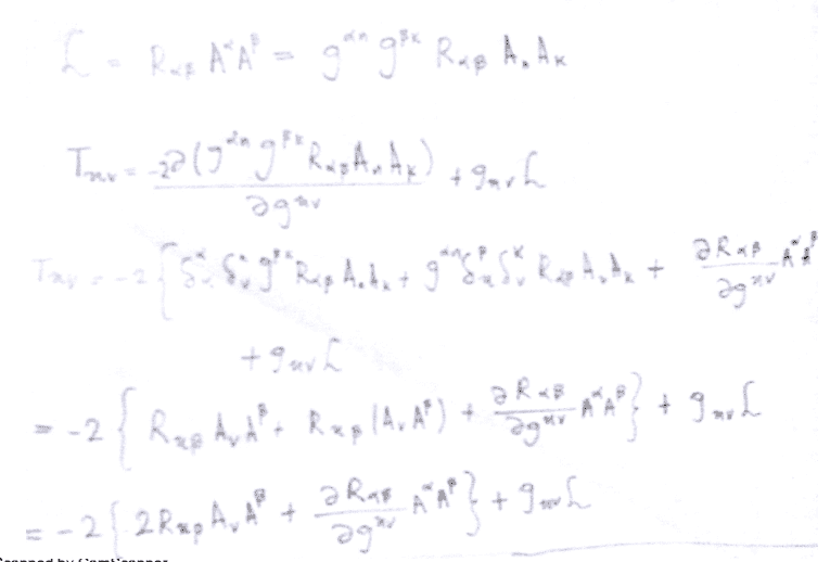

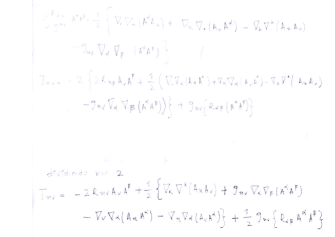

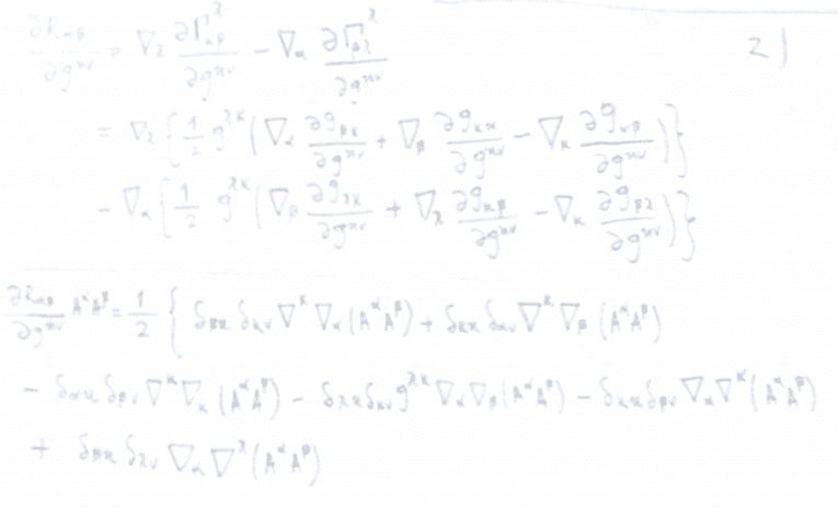

I try to calculate the energy tensor, but i can't do it like the article, and i don't know, i have a photo but it don't look very good, sorry for my english, i have a problem with a sign in the result
In the photos you can see the attemp at a solution
  • Handwritten derivation of the energy-momentum tensor from a Lagrangian density L = R_{αβ} A^α A^β = g^{μν} g^{βκ} R_{αβ} A_μ A_κ, with the metric variation and tensor index manipulations written line by line.
  • Handwritten derivation of tensor expressions with partial derivatives, covariant derivatives and index contractions, numbered equation 2, followed by a longer line expanding the result into four terms with delta factors.
  • Handwritten derivation of an energy-momentum tensor T_mu nu in terms of covariant derivatives of a vector field A, with a final line dividing the expression by 2.

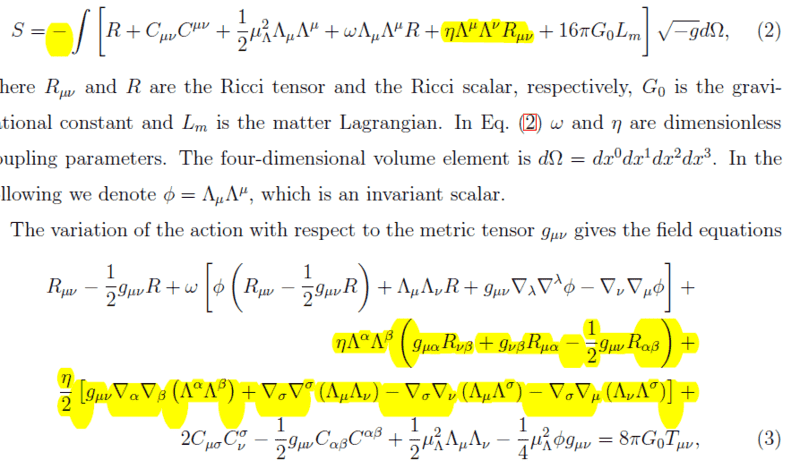

This is the problem
  • Typeset action integral S over a Lagrangian with R, C terms, Lambda terms, omega and eta couplings, 16 pi G0 Lm, and the field equations for the metric variation, with highlighted terms.
