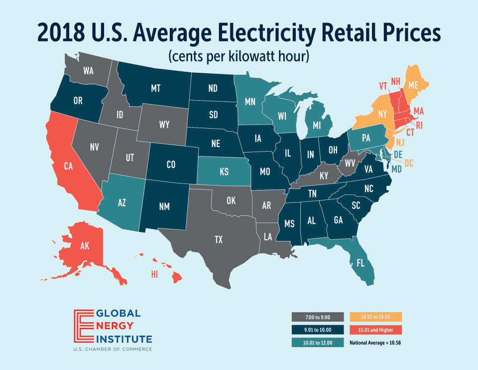

But it is not just AU, the prices are also high in Europe and in California.
Also compare to US states and you see a wide range, but none as high as Australia.

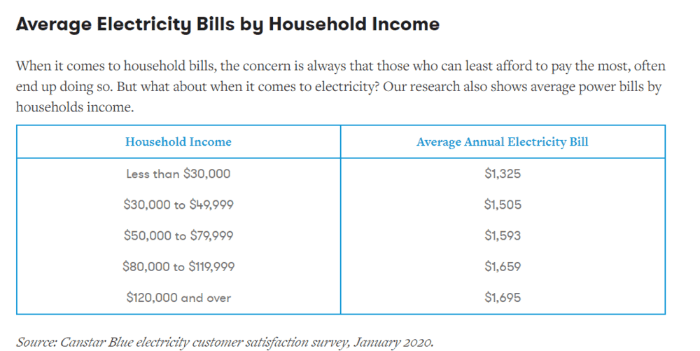

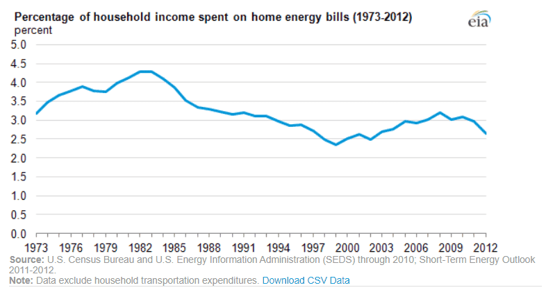

But it can be more meaningful to express it as a % of household income. In this measure, the USA is also low, compared to other countries. Note that the US numbers are for all energy, not just electric. Non-electric home heating is still a big part of some home energy bills.
In Australia https://www.canstarblue.com.au/electricity/average-electricity-bills/
Be careful comparing, US numbers were for all energy, the AU numbers for just electricity.

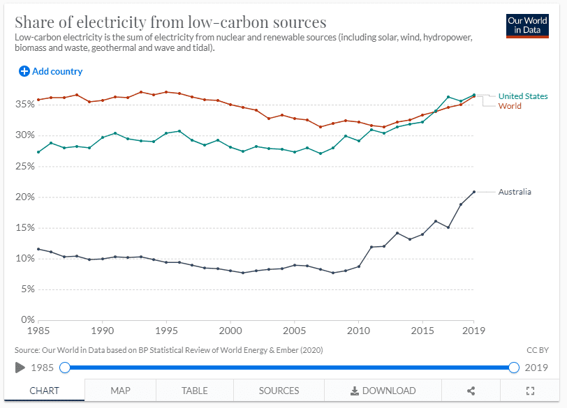

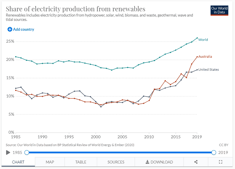

Is it necessarily true clean energy is the sole cause? Overall, Australia generates a much lower share of its electricity from low-carbon sources than the US, despite electricity being much cheaper in the US. Maybe some of the high costs result from how Australia is implementing its transition to electricity sources with low CO2 emissions, but the data don't seem to suggest that simply having more electricity generation from low-carbon sources directly causes high energy prices.
https://ourworldindata.org/grapher/...ime=earliest..latest&country=OWID_WRL~AUS~USA
While most of this difference in low-carbon electricity generation is mostly from nuclear power generation, the share of electricity generated from renewables does not seem to support the hypothesis that renewable energy is solely behind the higher electricity costs in Australia. Australia generates a slightly higher share of its electricity from renewables than the US, but this difference doesn't seem large enough to explain the differences in electricity costs:
https://ourworldindata.org/grapher/...ime=earliest..latest&country=OWID_WRL~USA~AUS

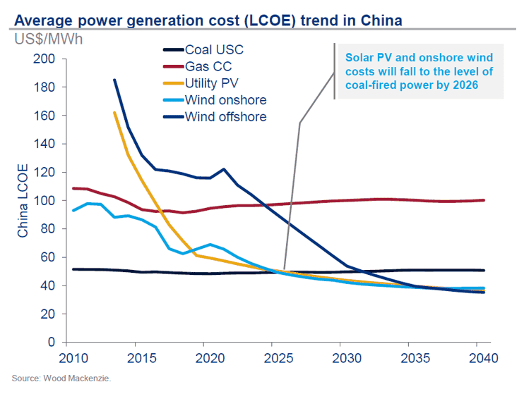

Here is China BTW, where coal plants can be easily built without the scrubbers and other environmental controls a Western country would require, showing a breakeven with Wind & Utility PV (in a less sunny locale than AU) a couple of years away.
https://www.woodmac.com/our-expertise/focus/Power--Renewables/china-renewables-lcoe/

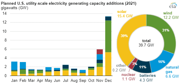

But renewables do dominate new construction: nat gas is only 16% of new capacity additions planned for this year:
main.svg
https://www.eia.gov/todayinenergy/detail.php?id=46416
To put a simplistic but finer point on it: every solar plant should include an equal capacity natural gas plant built right next to it and for the purpose of LCOE, they should be called one plant. Right now it is easy to pretend we don't have to do that, but if battery storage ever takes off, it will be harder to pretend that "that" giant battery wasn't installed because of a solar plant.
So are we doing it wrong? Per the EIA above, 27.6GW of wind and solar is getting built this year compared to 6.6GW of nat gas

You are comparing actual generation with my chart of planned new construction, so how that is relevant? All you data shows is renewables are a small % of current generation, so we don't have to worry that much about intermittency or other grid issues
As this shows:
the slated construction of new generation capacity this year is massively skewed to renewables.
If you want to quibble with LCOE, fine - but its a good starting point for discussion and very applicable in locations where renewable generation is a low percentage of generating capacity,
