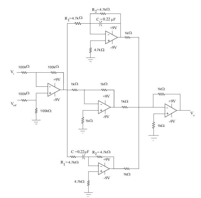

looking for ideas for an analog PID loop

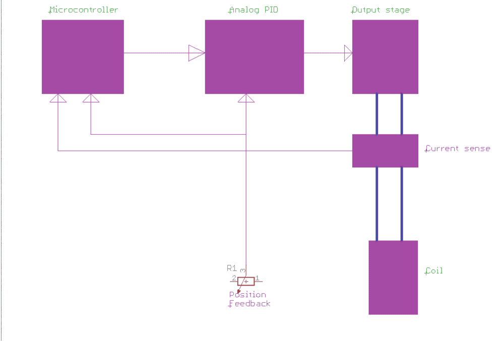

Once again I'm looking at a project that is challenging my engineering limits!
I have a type of metering device that has an electromagnetic coil that actuates it, it's designed to be relatively linear motion depending on amperage applied through it, and it has a variable resistor as a sensor for the actual position. It should be able to respond to changes in inputs quickly, which is one reason I'm considering to at least have part of it analog (Perhaps just a P-D loop, the integral could be software controlled)
I know it's possible to do everything in software, but if I can save processor power and code simplicity with a couple op-amps, I think it's a good move.
The microcontroller will either be a 3.3 or 5V unit (probably 3.3 because of processing power)

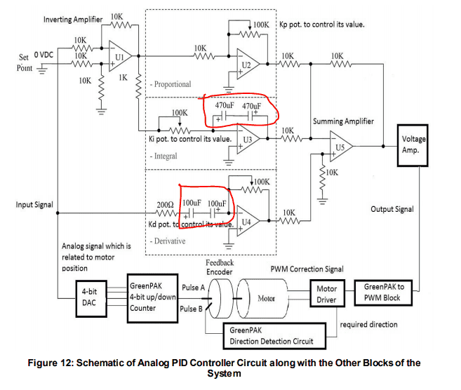

I found this image which may work with some minor modifications (supply rails would be 0 and +5V or +12V)
the second part is the output stage, wondering what sort of transistor and design would be well suited for it..there will be a low side current sense resistor, and low side switching would definitely simplify things.. I think 10A peak current is a reasonable starting point (I'm getting more detailed specs soon hopefully)

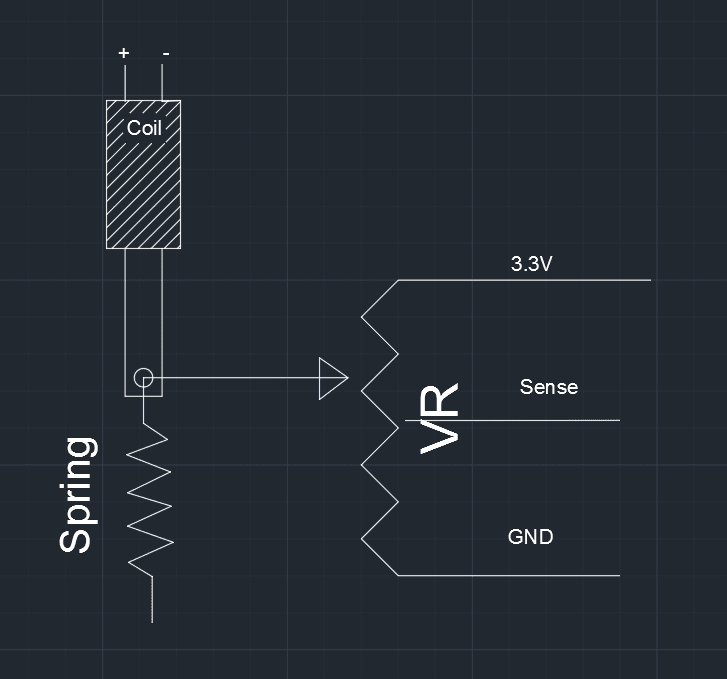

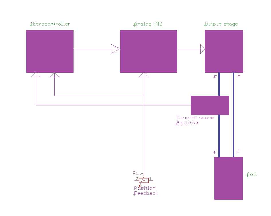

Here's a sketch of the physical portion, sorry for the terrible artistry
Block diagram of the electrical side of it

I would use the output voltage of the PID controller to control the duty cycle of a low-side N-channel MOSFET. A Schottky flyback diode across the inductor will protect the driver from flyback, and provide a path for flywheel current through the inductor while the MOSFET is off.
Choice of component rating will depend on solenoid specifications.
You must find a voltage to PWM controller. The simplest solution would be an LM555 timer, or a microcontroller with A-D inputs and a PWM output.
I'm certainly not an expert on control loops but I do know that delay in the feedback signal will cause instability. Your coil/spring gadget has this type of delay built in. I suspect you need only concern yourself with a PI controller. Drop the D.
Your controller must be able to outrun the dynamics of the physical system, so the “high-pass” differential part will be essential to stability. The “low-pass” integral part of the PID corrects only the long term error in position.
You will probably need an error amplifier with a controlled gain between the PID output and the PWM controller.

It is not the speed you need to move that is important. It is the speed the load can move while you are trying to control it that is important.

In the pic of the schematic I posted, isn't the first op-amp the error amp with a controlled gain?
I'd like to stick to 4 op amps since I can easily get those on a single chip and it doesn't take too much space, so I'd drop the integral,

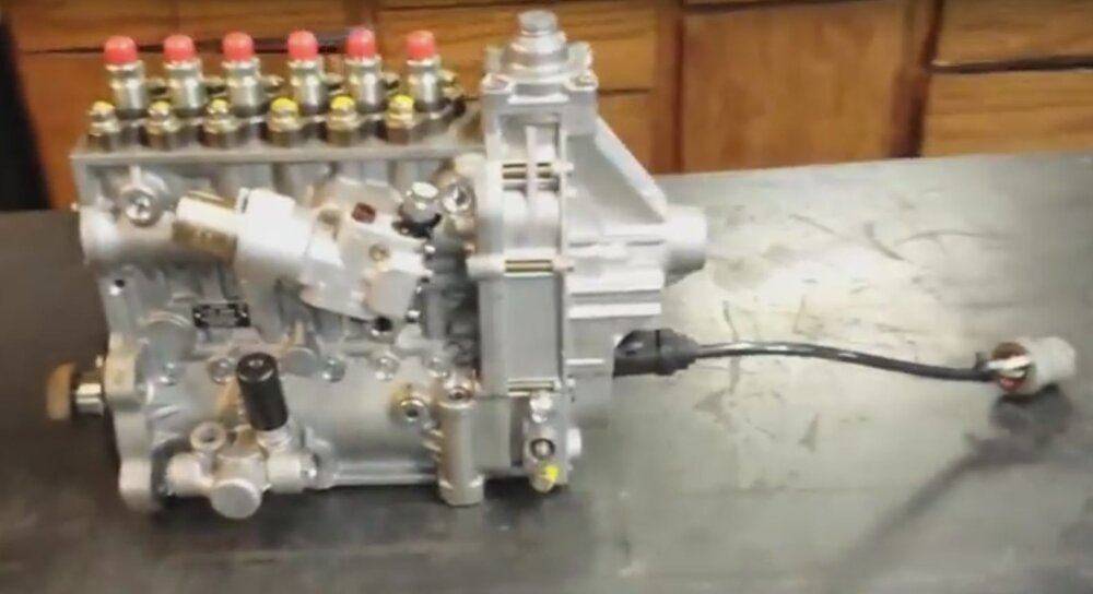

This is going to control the fuel control mechanicals on a diesel injection pump, 6 cylinder, 4000 RPM = 200 injections per second or 5 millisecond between events, I think if it took about 10 events for a 90% response that would be adequate. the system has two such devices, one controls the fuel quantity, and the other controls the timing.. they're functionally the same
I know the physical system is designed and engineered for the application, it's just I have no "brain box" for it.. I'm going to have to have enough to worry about with a PID loop for engine speed/load I don't want to have to worry about what the pump itself is doing
Here's the pump, it's a real unicorn, it's from the left bank of a Komatsu V12 and I'm thinking of repurposing it into a 5.9 Cummins
Your sketch indicates that is going to be a challenging project. You have a mass/force/spring oscillator whose force is a non-linear function of position.
I second the recommendation made by @Baluncore that some form of mechanical damping be liberally applied if you want fast response. This of course implies a more powerful positioner (solenoid).
The first steps to designing your device are to find:
  • the mechanical resonate frequency
  • decide what accuracy you desire
  • decide the minimum response time from a step input

Many mechanical injection pumps have a governor that controls fuel input based on the difference between RPM and accelerator position. Have you checked if your pump includes a governor? Have you checked if there is a dashpot built into the solenoid/rack to prevent oscillation flogging the six fuel control valves?
When matching pumps to engines you will need to set the maximum fuel injection limit to get full power without black smoke. The turbo will make that setting more complex.

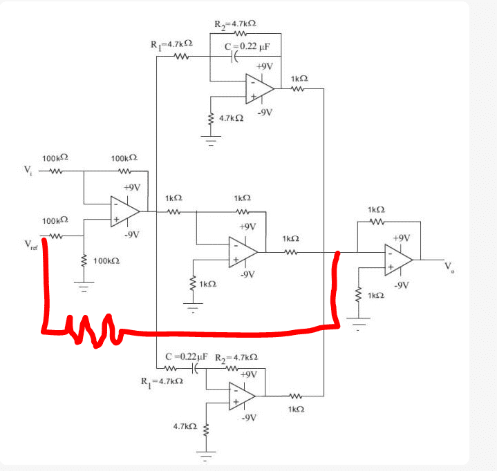

You show a common ground reference at zero volts. Since control signals move equally above and below ground you will need to use a common reference voltage at about half the supply. Maybe +12V as positive supply, 0V for negative supply, with say +5V as your local analogue common.
Looking at the schematic of the PID I see your error amp at the input. If the error is zero, the output of the PID will also be zero, maybe that will give 50% duty cycle. There needs to be an integral component in the PID so the error can be zero while the output to the PWM can be anywhere between 0% and 100% depending on the force needed to hold the rack and spring in that position.

For the output, an MCP14A1201 gate driver with a IRFIZ34N Mosfet (integrated flyback, 55V/21A, .04Ohm) transistor..
For the current sense, I looked back at the Dave's EEVblog on choosing a low offset precision opamp for his current sense project, the MAX4238 (1mhz GBWP) or Max4239 (6.4mhz) seems to be the cats meow
I'm told the solenoids take 6 amps peak, so designing it for 10 amps is probably good and makes easy math
using a 0.01ohm shunt resistor at 10 amps yields a .1V drop and 1W power dissipation if I'm doing Ohm's law right, I think 3W resistors in that value are readily available.. to get good resolution on a 3.3V ADC I'd probably go with a 30-33x gain and a lowpass filter in front of it so I don't see the individual switching of the mosfet... I don't think I'd need the extra bandwidth of the 4239 for this.

Your real problem is R2 across the capacitor that makes it forget the integral component in the capacitor.
It's not what the middle op-amp is already doing though, the middle op amp goes off setpoint error while putting a resistor from the setpoint to the output would be adding a linear component to it regardless of setpoint error.
You have a good point about R2, it's probably to prevent integral windup, or in some literature they call it the reset time I think? don't think you'd want too low a value there for sure

Why do you need to monitor the solenoid current? Is position insufficient? A simple RC LPF connected to the solenoid terminals could feed back to A-D, so integrity/health of the driver loop could be monitored.
You will need to tune the controller once it is running. That is best done by keeping coefficients in microcontroller EERAM. What microcontroller will you use? Can it be reloaded over a USB link or updated over CAN bus?

The main reason is I don't want to have to dedicate so much processor time to the calculations.. If you want decent response, I'd figure you'd have to do it every millisecond or so, and it's a fairly intensive operation between the ADC reads, etc.. Yeah, you'll run it on an interrupt, but there are other things that will be interrupt driven as well and managing those priorities is not going to be an easy task either
Then dedicate a microcontroller to the job of control.
You can set up a real time clock interrupt at 1 kHz. The first task is to update the PID and will take less than 10 usec. Most of the time the processor is asleep.
I agree that writing time critical code in a high level language is a challenge, but it is easier to hand craft assembly code for a microcontroller RTOS kernel than to design, build, debug and tune the analogue PCBs needed for a PID.
The I/O modules are autonomous so you can order an A-D conversion, it will be ready by the next interrupt. A message on CAN bus will call when it arrives, or when it has departed. The PWM will keep running until you update the duty register. The tasks needed can all be independent of program flow.

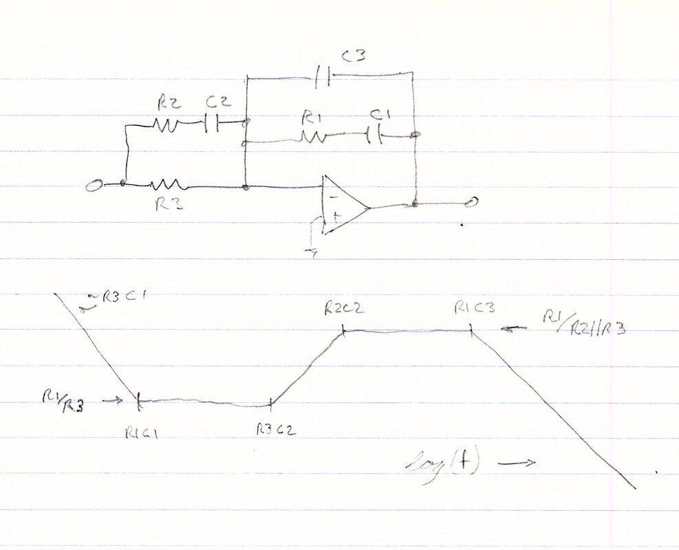

I read did not read the whole thread. I am just looking at the schematic of the first post on the opamps. I question what is the circuit doing as it looks to be a straight pass gain of 2 circuit. The top one is low pass with pole frequency of about 154Hz. The bottom opamp is high pass with zero frequency of 154Hz. Middle one is straight pass. So the input to output is just straight pass with gain of 2.
I ran LTSpice and that verify my suspicion
I know I don't understand all the details, but a straight pass is a straight, you can see amplitude and phase response are just simply straight pass with gain of 2. The simulation agree with me.
I use OP27 so the performance is out of the picture. I left off the resistors to the +ve input because it's irrelevant. I use single end driving at the input to simplify the circuit. These should not affect the result.

A brief comment about the schematic above (post #26 et. al.). First @yungman is correct, this has a flat frequency response with a gain of -2 (not counting the high frequency issues with op-amp gain-bandwidth limits). Thus it is a "P" controller, and would work just as well if you eliminated amplifiers U1, U2, U3, and U4 (and their associated components) and changed R1 to 50K. You can see this by inspection as @yungman described, it doesn't need a simulator.
However, my real point is that in analog circuits, differentiators only work at low frequencies. The desired frequency response (like H(s) = H0⋅s ) requires infinite gain at infinite frequencies, i.e. an amplifier with infinite gain-bandwidth. You can't buy those. However, the bad part is that the transition from an effective differentiator at low frequencies (where the amplifier works well) to high frequencies (where it doesn't) will essentially guarantee an unstable circuit. This is how you can build an oscillator, if you want. Be very careful with this part of the design.
In practice differentiators are always converted, at higher frequencies, to proportional (i.e. flat frequency response) or integral (decreasing gain with increasing frequency) BEFORE you exceed the amplifier's gain-bandwith product. That's what R12 does in this design.
I have no idea why R5 is included in this design. There may be a good reason, but I don't know what it is.
Finally, op-amps are really good these days, you probably don't need a separate amplifier for each of these different functions, just lots of well chosen R's and C's around one op-amp.
R5 supplies DC feedback around the Integrator. Without R5 any DC input to the circuit, or any input offset in U1 will quickly drive U1 into saturation because it is operating open-loop for DC.
R5, in conjunction with C1, also determines the corner frequency of the integrator (low pass filter as you call it).
In PID controllers the Integrator corner frequency is much lower than that of the Differentiator. Its purpose is when there is a small setpoint error (which there always is do to the finite Proportional gain), the Integrator will accumulate that small error and drive the output to the setpoint.
Cheers,
Tom
