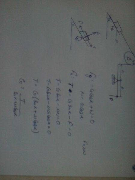

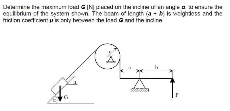

The discussion focuses on determining the maximum load G (in Newtons) that can be placed on an incline at an angle α while maintaining equilibrium. Key factors include the weightless beam of length (a + b) and the friction coefficient μ between the load G and the incline. Participants emphasize the importance of analyzing the forces involved, particularly the tension in the rope and the lever ab, to derive the necessary equations for equilibrium. Clear communication of equations and steps is essential for effective problem-solving.
- Understanding of static equilibrium principles
- Knowledge of force analysis in inclined planes
- Familiarity with tension and lever mechanics
- Ability to interpret and communicate mathematical equations
