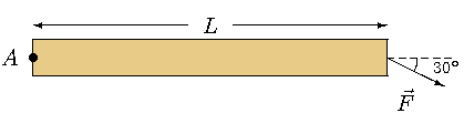

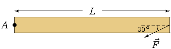

Do the following have equal moments about A?
Diagram of a uniform rod of length L with pivot point A at its left end; a force F acts at the right end, directed down and to the right at 30 degrees below horizontal.
Diagram of a horizontal beam of length L with a pivot point labelled A at its left end, and a force F shown at the right end acting at 30 degrees below the horizontal, pointing down and to the left.
T=rf
Yes because using L*cos(30), they will be the same?

Your reasoning is incorrect ...
τ = r×F
τ = rFsinθ
or τ = r times (component of force perpendicular to line joining A and point of application of force )
So what is τ ?
They both use τ = rFsin30 right? That means they are equal! Right?

"Use" is a strange word there. "Supply" perhaps. Anyway, you asked whether your reasoning was correct, and Tanya S was right in reply, that your reasoning was incorrect (though you got the right answer).
