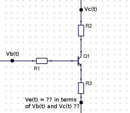

Hi,
as mentioned in my previous thread, I'm currently busy with a 'small' project of translating an analog device (synthesizer, based on schematics) into a digital (software) version.
I know 'nothing' about EE, I'm a Computer Science guy, so hopefully this question is not too easy :-)
This question is about how to model the behaviour of a transistor. In the analog device, a single transistor is used as a voltage controlled amplifier.
- The control voltage envelope V_b(t) enters via the base of the transistor,
- the voltage to be shaped according to the envelope V_c(t), enters via the collector
- the output is a voltage V_e(t) of which was until now modeled as simply V_e(t) = V_b(t) \cdot V_c(t)However... later I noticed that every website about transistors say that I_e = I_b + I_c, so that would imply that it is impossible to get V_e(t) = V_b(t) \cdot V_c(t)So, my question is simply,
- given a control voltage as function of time V_b(t)
- given an input voltage V_c(t)
How do I calculate V_e(t) in terms of V_b(t), V_c(t), R1, R2, R3 and any transistor dependent constants?
Thanks in advance!

Even if Vb and Vc are derived from ideal voltage sources, you cannot just dangle Ve like that. (Well, you "can", but I don't think that the transistor would do anything. I don't know what would happen, actually.) For instance, perhaps there is another resistor (i.e. a load) connected from Ve to ground?
BTW, what kind of transistor is it? The symbol that you have used suggests npn, perhaps 2222.

The 1st equation highlighted in bold is dimensionally inconsistent. You cannot multiply 2 voltages and get a voltage. Are you trying to perform an analog multiplication of 2 signals? There are circuits that do that. I would search "analog multiplier" or "Gilbert multiplier".
The 2nd bold highlight can be answered as follows. By "Ve", I presume you mean the emitter potential with respect to ground. Look up the "hybrid pi equivalent" model of the bjt operating in small signal mode. The bjt parameters are "r_pi, hfe, & gm or re". Also, r_pi = hfe/gm, where gm = Ic/Vt, Vt = kT/q. You can then compute the ac gain, i.e., Ve will be a function of Vb, the resistor values, and bjt properties. Selecting the right values for the R's minimizes the bjt parameters' influence on circuit behavior.

turin, cabraham, thanks for your replies.
I think my question was perhaps not clear or incomplete:
turin: The schematic is just a small part of a larger schematic to illustrate my question, that's why there's no ground.
If you interested, please take a look at transistor Q65 in cell J8 of this schematic:
http://www.kolumbus.fi/janne.husu/specs/909vb.gif
The transistor in question is a 2SC2603-F (no longer in production - but the datasheets are available)
cabraham: I do not try to do (analog) multiplication of two voltages. In the software model I'm building, I incorrectly assumed that the behaviour of a transistor VCA could be approached by multiplying the envelope signal (at base) with the input signal (at collector).
I will look into the hybrid pi equivalent model to see if I can use it to model the behaviour of a single-transistor VCA.
Thanks again for your help.

What's the difference? What's VCA? Anyway, that is certainly not the behavior of Ve given Vb and Vc.
BTW, the model of the transistor can be very dependent on 1) the type that you are using, and 2) the surrounding circuit connections to the three electrodes. For example, hybrid-π model may or may not be applicable. (Hybrid-π model is a small-signal model, correct?) I haven't looked at your schematic yet. I'll let you know if I can figure out what the transistor is supposed to do.

Upon cursory inspection, here's how I visualize your transistor circuit:
Firstly, it can be reduced no further than:
Q65, D91, D92, R408, R415, R417, R418, R423
It has three input voltages (ultimately for collector control) and one input current (base), and it produces one output current (emitter).
The three input voltages come from three op-amps? and are presented at the three resistors: R408, R415, and R417. The three currents feed into the voltage divider circuit of R418 and R423, but the maximum input voltage to this divider is clamped by the diode circuit of D91 and D92. (Is that the right term - "clamped"?). The output of the voltage divider provides a Vc at your transistor.
Since the emitter is connected directly to a negative op-amp? input, the positive op-amp? input is grounded, and the op-amp? has negative feedback, the emitter voltage is held at 0 V.
So, the three input voltages basically control Vce (subject to the diode clamp constraint), without negative emitter feedback. The output of the transistor is a current output that flows through the op-amp? feedback RC circuit.
With the given Vce, the output current is basically determined by the input current at the base. This current comes from Q64 through two resistors: R401 and R403. I think that these resistors are mainly for filtering and feedback to Q64.
So, this looks like a base-to-emitter current amplifier circuit that is somehow controlled by three voltages (which somehow work together to determine the current amplification by controlling Vce). I don't know if the diode circuit is just for protection, or if it has a functional purpose.
