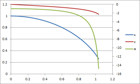

Got the same picture doing a simple numeric integration with excel:
(x on the left axis, v and a on the right axis)Basically the mobile charge just "falls" towards the fixed charge in the same way a small mass falls towards a planet: initially slowly (the change in attractive force is small) and then accelerating faster and faster.
