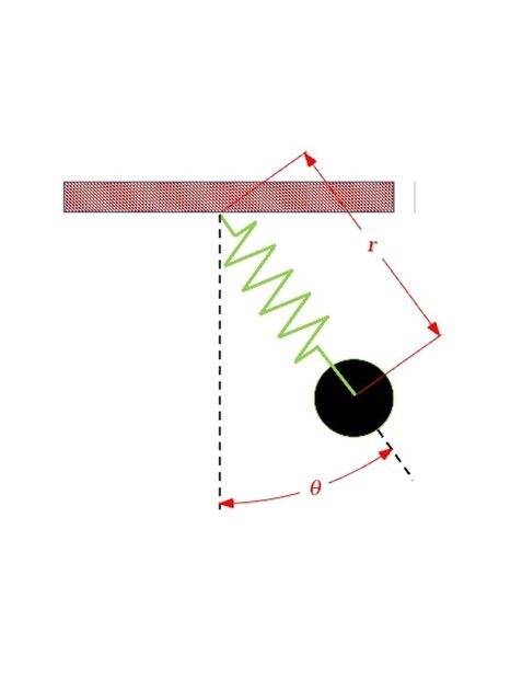

Given the pendulum setup below:
Details:
##m## is the mass of the bob
## r ## is the instantaneous length of the spring
## \theta ## is the angle the bob makes w.r.t vertical
## I ## is the bobs mass moment of inertia about pivot
## l_o## is the free length of the spring.
##k## is the spring constant
The spring is assumed not to deflect laterally and is ideally massless. It is elevated to the angle ## \theta## at its free length without stretching and released. Summing torques about the piviot ## \circlearrowright ^+## I arrive at:
$$ r m g \sin \theta = I \ddot \theta \tag{1}$$
Next shift frame of reference to the mass and apply Newtons Second ( non-inertial frame) in the direction of ##r## with ##\searrow ^+##
$$ m \ddot r = mg \cos \theta -k\left( r - l_o \right) + mr {\dot \theta}^2 \tag{2}$$
I've never really gone further with solving a system like this. What I was thinking of doing was solving ##(2)## first treating ## \theta ## and ## \dot \theta ## as parameters such that ##(2)## becomes:
$$ \ddot r + \left( \frac{k}{m} - {\dot \theta}^2 \right) r = g\cos \theta +\frac{k l_o}{m}$$
where I solve for ##r## as a second order ODE with constant coefficients, in other words solve##(2)## as:
$$ \ddot r + \beta r = \kappa $$
Then use that result to numerically solve ##(1)## for ##\ddot \theta## with a small time step where I assume it is constant over that small interval.
Is that nonsense?

erobz said:
Is that nonsense?
There is probably no one solution to the system.
Approaching the system from a different direction: Looking at the simplest model, I see two oscillators, the swing and the spring, that have independent natural frequencies. The pendulum bob mass will therefore move in an endless radial Lissajous figure.
But because the length of the pendulum will change the natural period of the swing, and the swing will change the vertical force, changing the length of the spring, the oscillators are coupled in a way that will phase lock to some longer period.
Neither oscillator will show its exact independent natural period, but those natural periods will be pulled slightly, until they are at an integer ratio to each other, repeating over a longer period. The radial Lissajous figure, described by the bob mass, will therefore be stable over that longer repetition period.
Just what that integer ratio will be will depend on the trajectory followed to the (initial) phase lock that is stable. There will be a whole field of stable lock integer ratio peaks available, separated by transitional saddles of differing depth.
Since for a specified swing angle, the coupling between the oscillators will be well-defined, it would be interesting to numerically simulate the model, to plot that field surface.
As energy is lost, the swing amplitude will reduce over time, so oscillator coupling will then change. How will the oscillators then transition to peaks with different integer ratios?

erobz said:
Yeah, it doesn't look like I have the equations correct... apparenly there must be a torque component I missed involving ## \dot x \dot \theta ##
The torque equation is ##\tau = \dot L##, where ##L = mr^2 \dot \theta## is the angular momentum.
Note that ##\dot L \neq I \ddot \theta##.
  • Wow
