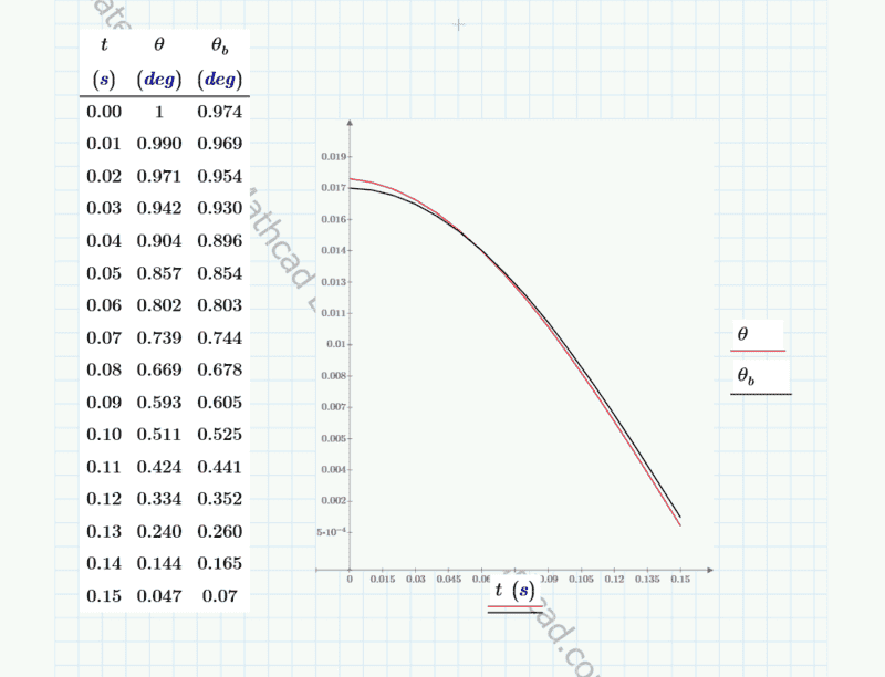

Here are my numbers. I had to use k=100000 which I think is effectively infinity.
time Theta (deg) Omega
0.00e-00 9.740283e-01 -1.699498e-08
1.00e-02 9.691587e-01 -1.697514e-02
2.00e-02 9.545089e-01 -3.385784e-02
3.00e-02 9.302843e-01 -5.036643e-02
4.00e-02 8.969097e-01 -6.628610e-02
5.00e-02 8.544609e-01 -8.159551e-02
6.00e-02 8.034811e-01 -9.608209e-02
7.00e-02 7.444282e-01 -1.096150e-01
8.00e-02 6.784094e-01 -1.219674e-01
9.00e-02 6.052226e-01 -1.331803e-01
1.00e-01 5.258211e-01 -1.430802e-01
1.10e-01 4.414393e-01 -1.515175e-01
1.20e-01 3.524622e-01 -1.584575e-01
1.30e-01 2.602780e-01 -1.637955e-01
1.40e-01 1.650533e-01 -1.675184e-01
1.50e-01 6.910897e-02 -1.695483e-01
I changed my ##\Delta t = 0.005 \rm{s}## because I wasn't sure what level of precision your simulator was using.
You are the black plot ## \theta_b## , mine is the red plot ## \theta##
Table of time t in seconds against angle theta in degrees and theta_b in degrees for t from 0.00 to 0.15 s, beside a line graph of the two angle curves against t, the red theta curve and black theta_b curve both falling to near zero at 0.15 s.
Not a perfect match, but there seems to be some aberrations that could be blurring it. I don't know...I guess It is probably worth the full treatment.
Yours has that slight offset from ##1 ^\circ ## and seeing them plotted, I found that I had double defined my all my parameters on the first step. The tangent to the graph at ##t=0## should be horizontal (I can see that the red curve is not), I'll fix that.

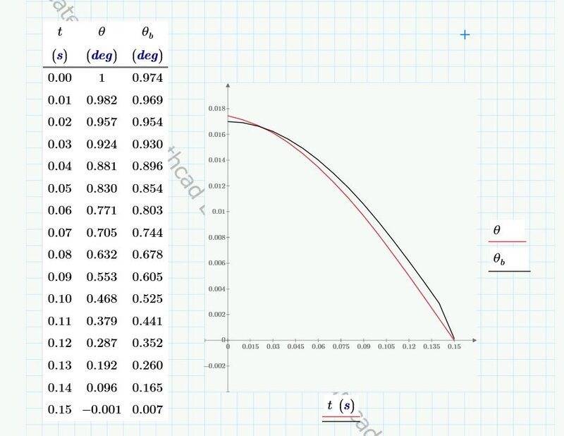

Fixed
Left: table of time t (s), theta (deg) and theta_b (deg) from 0.00 to 0.15 s. Right: graph of theta and theta_b against t (s), two near-identical downward curves, with a red and a black line.
Now I'm feeling much better! What do you think? Maybe I should change mine though, it looks like it will dive under yours if I do.

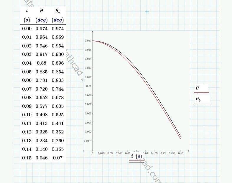

I've corrected the offset.
Table of time t in seconds against theta and theta_b in degrees, with a line graph of theta (red) and theta_b (black) versus t from 0 to 0.15 s, both curves falling from about 0.017 to near 0.0005.
Given that its reasonably in agreement, I probably will write the numerical solution with traditional programming. Going away for the holiday weekend though. Maybe next week?
It will be neat to see if that amount of disagreement given the potential of chaotic motion will spell disaster. Then again, when I am able to decrease my timestep perhaps they will get better.
