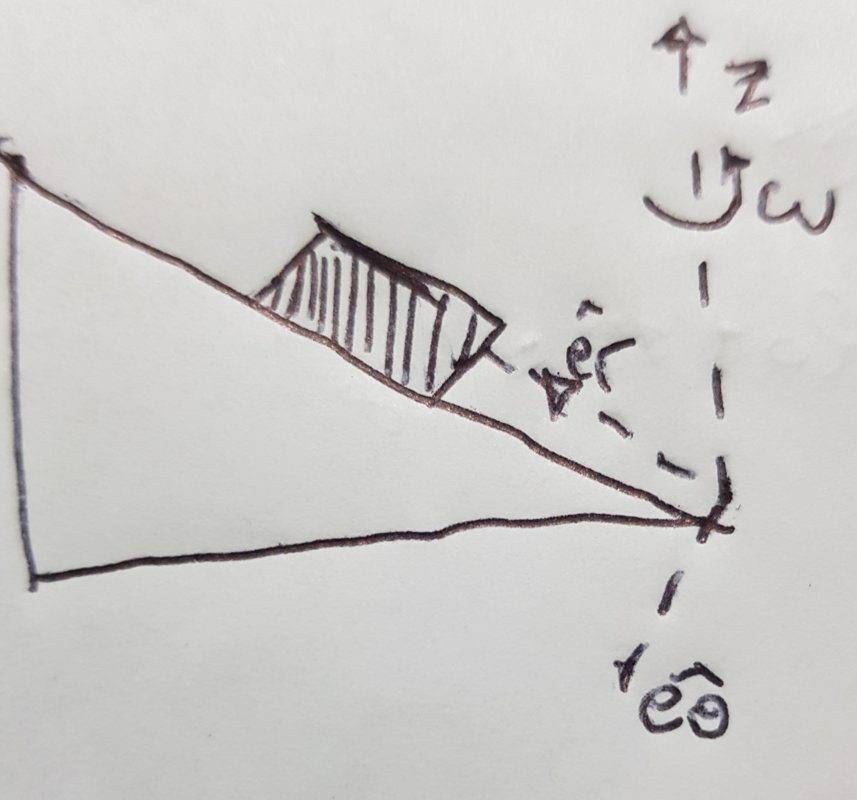

The wedge spins with angular velocity ##\omega##. There's a block of mass ##m## on it which is restricted by a slot to slide down. Determine the acceleration of the block. Is there any force acting on the walls of the slot? How can you calculate it?
##\Sigma F_{e\theta}=m(2\dot r \dot {\theta})##
##\Sigma F_{er}=m(\ddot r -r\dot \theta^2)##
I think that the only force acting on the wall is the normal force caused by Coriolis force, so it can be calculated this way:
##N=m2\dot r \dot \theta##
But ##\dot r## is not constant, so how can I calculate it?
Then, I can't calculate the acceleration either since I don't have the value of ##\ddot r## to plug in the equation

Are you not told the angle of the wedge?
Yes the angle must be given. As I understand there is a vertical plane that contains the block, the wedge and the axis z and this vertical plane rotates with constant angular velocity ##\omega.## The block is compelled to stay in this plane by the ideal constraint. The system has one degree of freedom.
If it is so then it is sufficient to write the law of energy conservation relative the frame that rotates together with the plane. The centrifugal force is a potential force

Let ##s## be a distance from the bottom angle of the slope to the block. Then the kinetic energy of the block (relative the rotating frame) is ##T=m\dot s^2/2##. And the potential energy of the centrifugal force is (think why)
$$W=-\frac{1}{2}m\omega^2s^2\cos^2\alpha,$$ here ##\alpha## is slope's incline angle.
So the energy is conserved:
$$T+W+mgs\sin\alpha=const$$
Differentiating this equality in time we get the equation of motion: ##\ddot s=\ldots##.
I also feel that this problem is actually about relative equilibrium of the block. The equilibrium can be found as a critical point of the potential energy ##V(s)=W+mgs\sin\alpha##
This equilibrium is unstable as a maximum of the potential energy
UPD: there must be square on cosine. Corrected

I've made a mistake with my notation... when I wrote ##\dot \theta## I meant "the ##\theta## direction from polar coordinates". So the angle of the wedge has nothing to do with it. Let's call it ##\alpha##

Something is keeping the wedge rotating at a constant rate. If the block changes radius its KE will change. This must be from a normal force from the side of the slot.
and this force does not work relative to the rotating frame but it does work relative to the lab frame
That force would be caused by Coriolis force, wouldn't it?
for the observer sitting inside the rotating frame the side reaction from the wedge is equalized by the Coriolis force ; in the lab frame the Coriolis force does not exist and the reaction causes acceleration of the block
