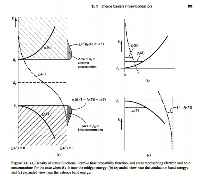

Hello. I was studying the Semiconductor and I am confused with this diagram.
I have attached the diagram. Please tell me briefly what does this diagram say. So that I could ask further. I have confusion with this diagram. I don't want to be specific so that you describe the whole diagram briefly and I will try to understand it.

fF(E) is the probability that a state is occupied, as determined by the Fermi distribution (left=0, right=1). It is close to 0 for states of high energy (top part of the plot) and close to 1 for states of low energy (bottom).
gc is the density of states in the conducting band with that specific energy - it is zero at Ec and increasing for higher energy.
To find the number of electrons with a specific energy, you multiply both functions, and get the shaded area. Its area is (proportional to) the total number of electrons.
gv is the same in the valence band.

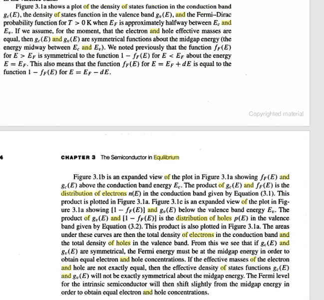

Thank you for your kind reply. Here is another image.
I am confused with a sentence "We note previously that the function f(E) for E>EF is symmetrical to ...", last four line of the first paragraph.
Would you please help me in understanding how f(E) for E=Ef+dE is equal to the function 1-f(E) for E=Ef-dE.

Close to the Fermi energy and for small temperatures (always true in semiconductors), the function is nearly point symmetric with f(EF)=1/2 as symmetry point.
That relation is just another way to express this symmetry.
Here is another image. sorry friend.
Now you can see the last 4 lines of the first paragraph in the given image.

I posted an explanation in post 4.
I read your post several times and I got what you have said. Thank you. It is cleared now. I hope you will help me next time if I post another thread for help.
