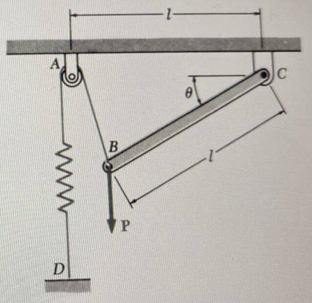

At the end ##B## of rod ##BC## a vertical load ##P## is applied. The spring constant is ##k## and it forms an angle ##\theta=0## when the spring is unstretched.
a) Neglecting the weight of the rod, express the angle ##\theta## corresponding to the equilibrium position in terms of ##P##, ##k## and ##l##. Sol: ##\theta =\arctan \dfrac{P}{kl}##
b) Determine the value of ##\theta## corresponding to equilibrium if ##P=2kl##. Sol: ##\theta =63,4\, \textrm{º}##
##F=k\Delta x##, ##\sum M_C=0##
Figure:
Diagram of a rod BC hinged at C on a ceiling, with a spring from pulley A to point D, a force P hanging down at B, and angle theta at C; length l marked.
Attempt at a Solution:
$$F=k\Delta x=lk\sin \theta$$
$$\delta x=0 \quad \textrm{when} \theta=0$$

As I understand it, you have assumed that the support force (##\vec{F}##) from the spring is applied at an angle of ##\theta## from the vertical. This means that ##\vec{F}## will be at right angles to the rod.
Can you justify that assumption?

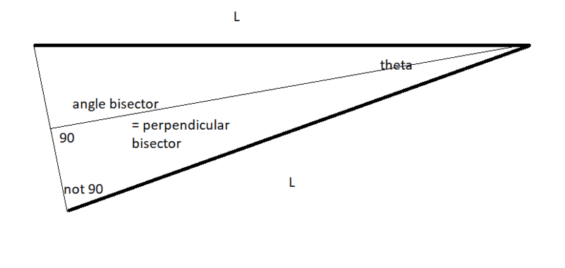

Guillem_dlc said:
Yes, isn't it?
The length of the bar is ##l##, the horizontal distance between supports is also ##l##. Try to form that "right triangle", you will notice something suspicious.
Also: It should be stated we are to neglect the size of the pulley.
I don't quite understand what you mean
What does the Pythagorean Theorem say about the lengths of sides in "right" triangles? Try applying it to triangle ##ABC##.
The pulley size remark? Or the isosceles triangle part?
Sketch of a triangle with a horizontal top side labelled L, a pulley drawn as a small circle at the left vertex, and an angle bisector from the right vertex marked theta, meeting the left side at 90 degrees, labelled perpendicular bisector; the bottom side is labelled L and the lower-left angle is marked not 90.
  • Triangle with two sides labelled L, a thick top side and a thick lower side, an angle bisector from the right vertex marked theta, and the bisector labelled as also a perpendicular bisector, with angles marked 90 and not 90.
Guillem_dlc said:
Homework Statement:: At the end ##B## of rod ##BC## a vertical load ##P## is applied. The spring constant is ##k## and it forms an angle ##\theta=0## when the spring is unstretched.
When the spring is unstretched and ##\theta = 0##, points A and B are coincident (assuming that ##l## is much greater than the pulley radius). As the spring is stretched under the load, point ##B## describes a circle of radius ##l##. Triangle ACB is isosceles (##AC=BC##). What is length ##AB## in terms of ##\theta##? By how much does the spring stretch?
