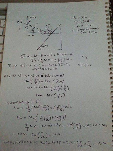

I've got the sum of forces in y and the moments. Just don't have the sum of forces in x.
Are the ones I have correct?

Use the diagram in post #16 as a basis for doing a clear free body diagram for the bar .
Show us the three equations that you should now have and , if possible , your final solution .
  • #35
I already drew the free body diagram on the basis of post 16 and attached it in one of my previous posts and I already mentioned the 2 equations I get from the forces in the y direction and the moment around A, just doing it for the x direction now and that should give me the answer.
  • #36
Solved! Thank you
